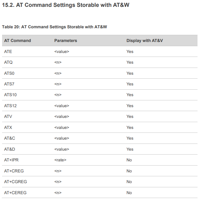

Checked the modem manufacturer manual, and it seems like this command cannot be stored in the configuration. Here is the list of commands that can be stored with AT&W:
So this command must be ran every time the device boots up.
