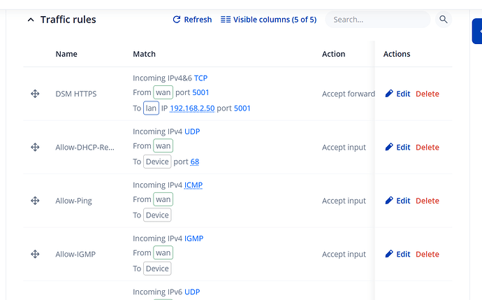

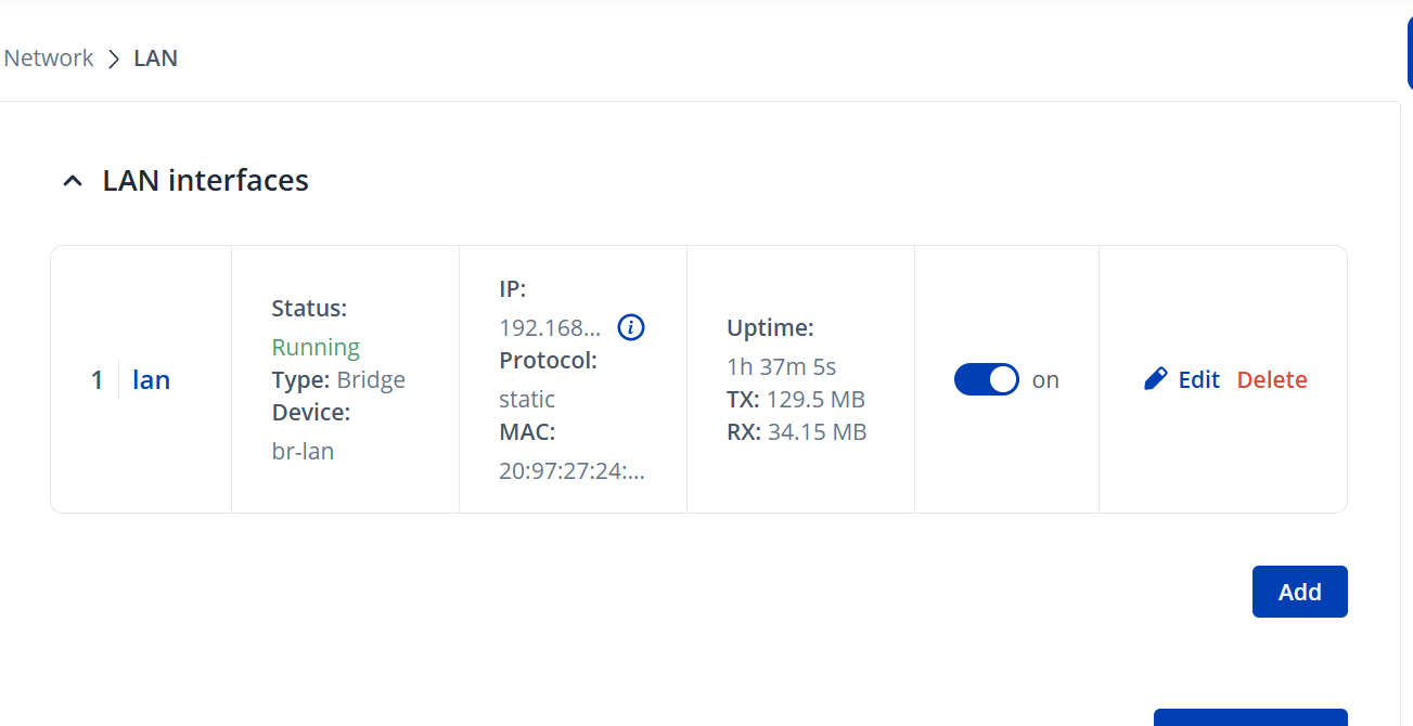

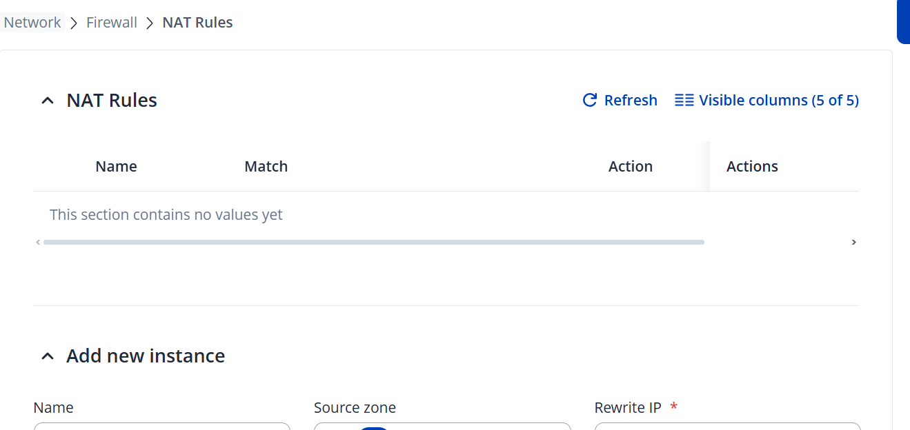

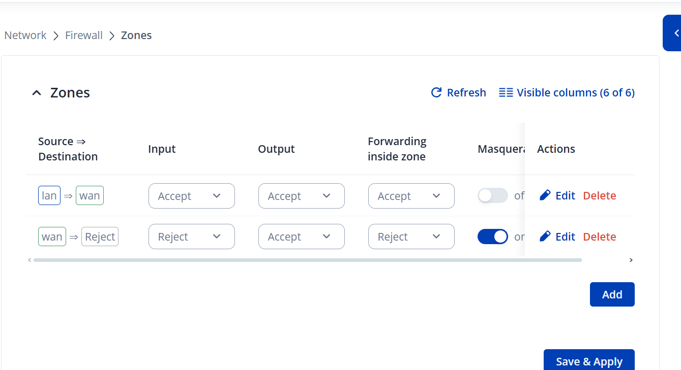

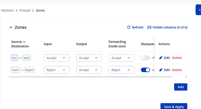

It took a while, but now the new configuration is in place.
The SIM card has a fixed IP address.
The TRB500 has been reset.
I still can’t open any ports.
Outbound traffic (to the internet) works fine.

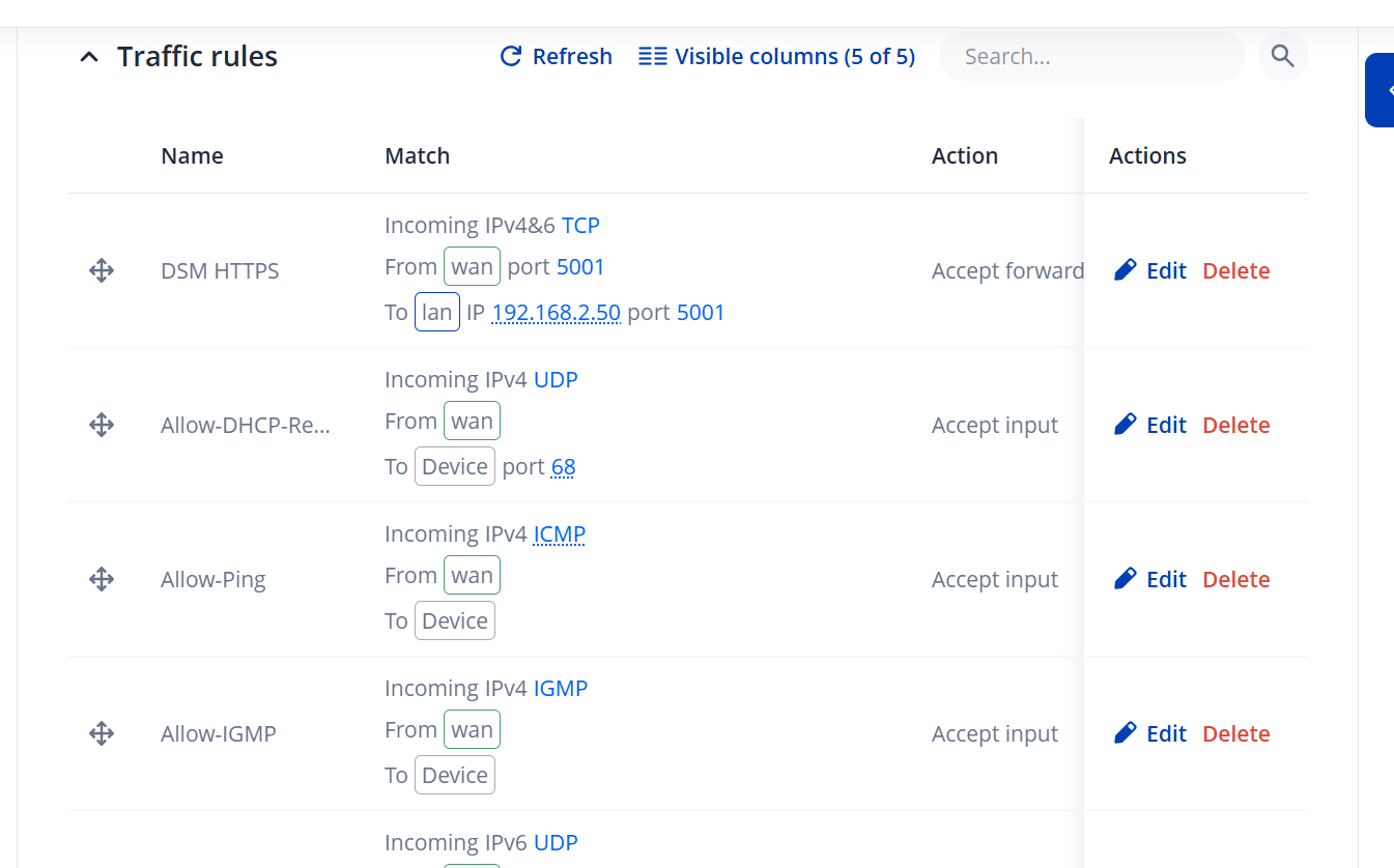

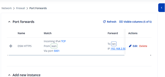

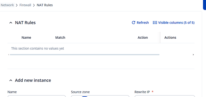

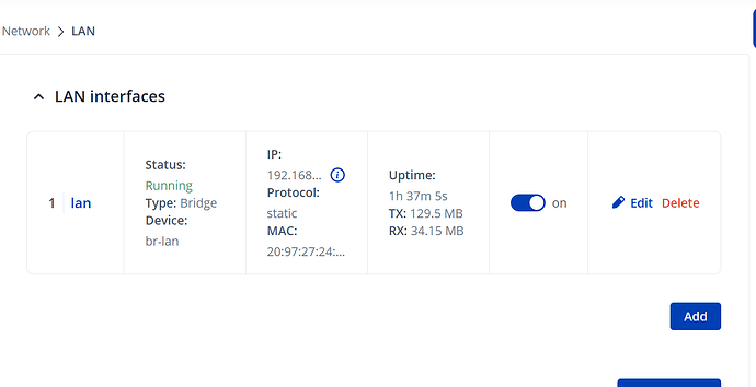

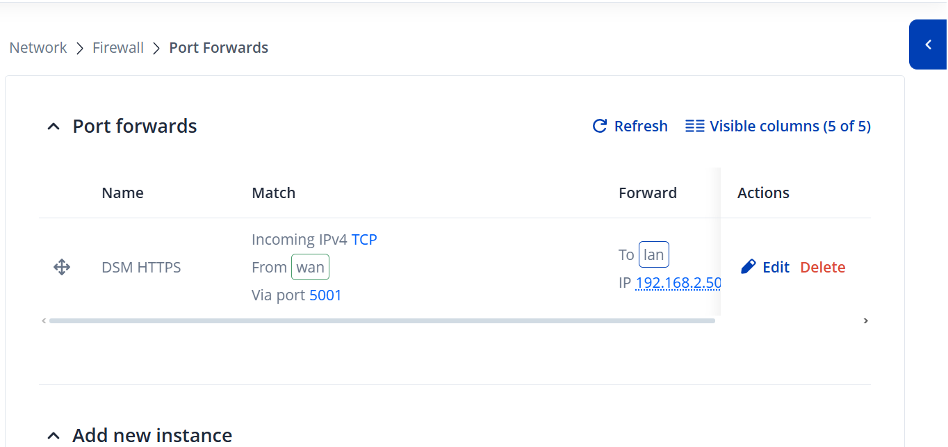

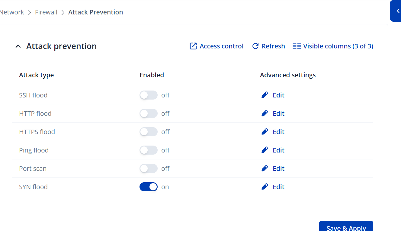

The goal is to open one port, in this example port 5001.
I am including some images so you can see what I have done.
If you manage to open one port as an example, that would be a great help.
Many thanks,
Peter Heynemann
Thank you for the update.
Have you had a chance to look at the port forwarding example article? In your case, a single port forwarding rule from the WAN external port 5001 to the internal port 5001 on 192.168.2.50 should be sufficient.
Just to confirm, is remote HTTP access enabled on the device?
Also, could you please share the first two octets of the IP address assigned by your carrier?
As a side note, the traffic rule you’ve added isn’t required for this setup, so you can go ahead and remove it.
Hello Martynas,
Thank you for your reply.
I followed the port forwarding instructions exactly and reset the system several times to ensure that previous errors did not occur.
Unfortunately, I was unable to open any ports.
Port 5001 is the remote port for HTTPS on the Synology NAS.
(It works perfectly in a “normal” fiber optic + FritzBox environment.)
The IP number provided by the provider is: 10.148.X.XX.
The APN is “fixedip.m2m”
According to the provider, this is a “Fixed IP” with “Machine to Machine” APN.
I will remove the unnecessary “Traffic Rule.”
Question:
Do all rules have to be filled in for the release of a port?
Such as:
“Zones”
“Traffic Rules”
“NAT Rules”
“Port Forwarding”
Or are only the “Port Forwarding” rules sufficient?
Thank you again for your help.
Peter Heynemann.
