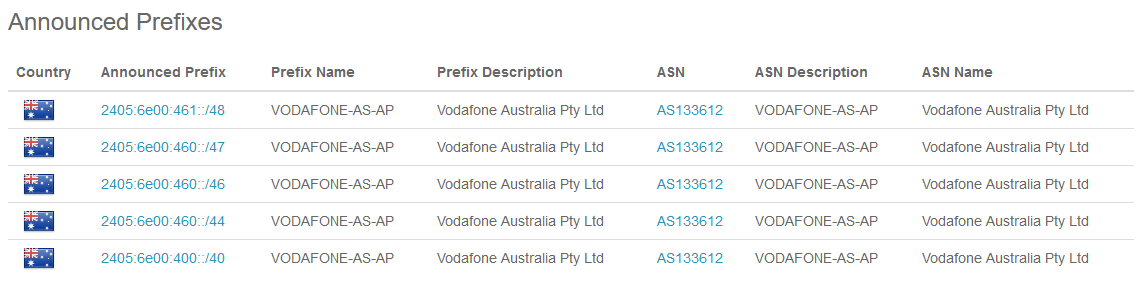

It looks like the issue lies with Vodaphone, some SIMs appear to have IPV6/IPV4 and others don’t. I think Vodaphone is doing a phased rollout for IPV6 capability as part of infrastructure upgrades, but full IPV6 capability isn’t deployed carrier wide. Both my phone and router are on the exact same plan.

Thankyou @Baseline - this is useful information, and precisely what I suspected but didn’t have any understanding to confirm.
I think Telstra has full IPV6 capability within their network, I bought the my Vodaphone SIMs from the exact same vendor at the exact time; one of them supports IPV6 and the other does not.
