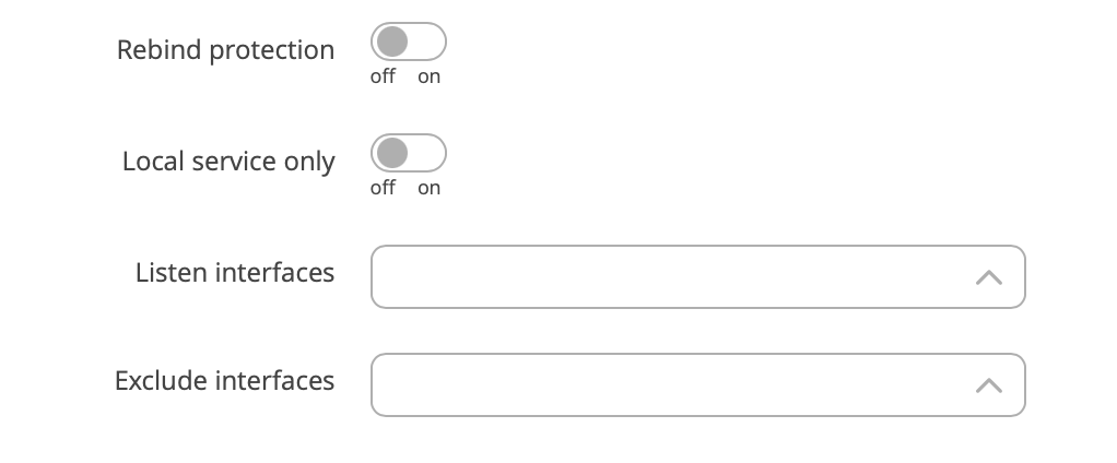

I get error while trying to change /network/dns configuration on WebUI
Where can I find config for those dns settings via CLI?
Any help would be appreciated Thanks in advance

This error most likely indicates, that some information that you have entered is invalid. However, you could try manually editing the dns configuration via the CLI by running the command vi /etc/config/dhcp
, under the dnsmasq configuration. More advanced config file is also available in /etc/dnsmasq.conf

Only thing I was changing is the toggle switches
Main reason for changes is that I have unstable dns.
Device stops responding to the dns lookups and it occurs network loss for clients on the lan.
IP routing works fine in the meanwhile…
You were right when I cleared the Listen interface and the exclude interface at the same time as switching the toggles I was able to save the config
