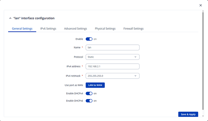

To bridge the connection to the ORBI 7 mesh, you can try keeping the DHCP settings of the TRB500 on and in the IPV4 netmask type in 255.255.255.0, this will ensure, that there will be 254 usable IP’s in the network. Then connect the device to ORBI 7 Router’s LAN port.
With this configuration, the TRB500 will distribute DHCP leases, and all devices within the same subnet will receive appropriate IP addresses. Please also make sure that the ORBI 7 router is configured to operate within the same subnet as the TRB500.
Please note that DHCP in ORBI 7 Router should be disabled to prevent IP conflicts.
