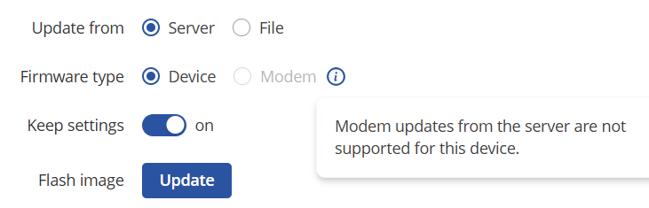

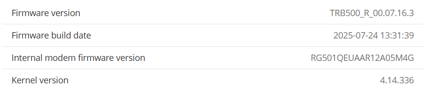

My TRB500 is on modem firmware RG501QEUAAR12A05M4G, which seems old.
The device does not seem to be capable of doing an update of the modem firmware by downloading it from your services.
How do I obtain a updated modem firmware?
How do I then install it?

My current FW is
RG501QEUAAR12A08M4G
