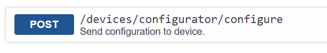

Configuration API - https://api.rms.teltonika-networks.com/devices/configurator/configure

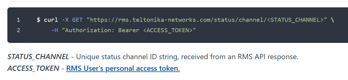

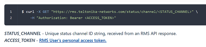

Status API - https://rms.teltonika-networks.com/status/channel/{channel}

Could you please then take a screenshot of the endpoints you are using, or list them explicitly (e.g., GET /devices)?
Thank you.
Configuration API
Status API
Since POST and GET are different methods that function differently, a POST request can only modify configuration, while a GET request can only retrieve it.
This means that changing and retrieving configuration cannot be done in a single request—they must be handled with separate requests.
