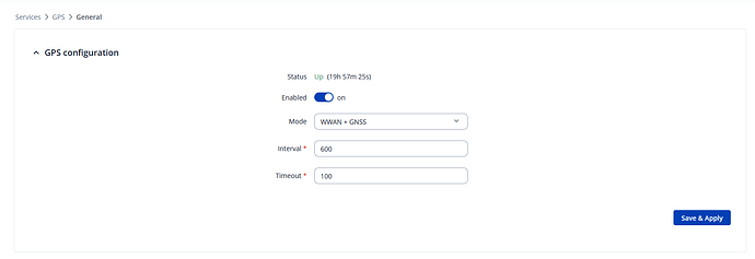

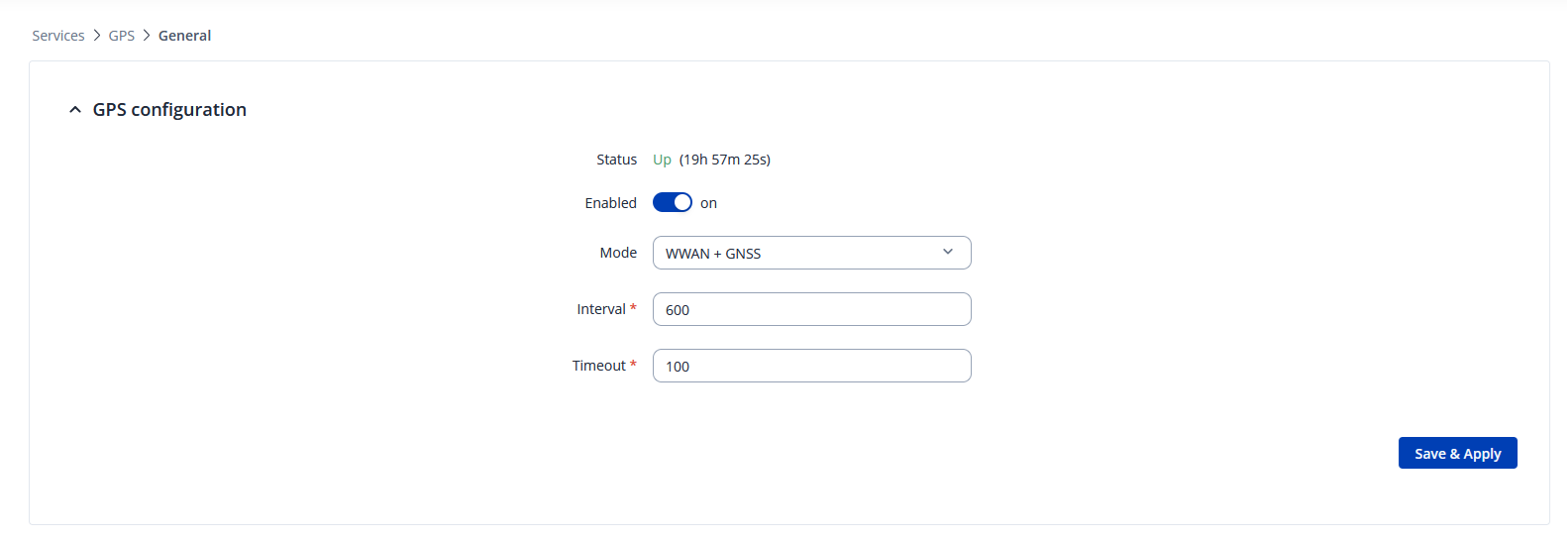

GPS location done with 600s wait. 100s GPS fix timeout.

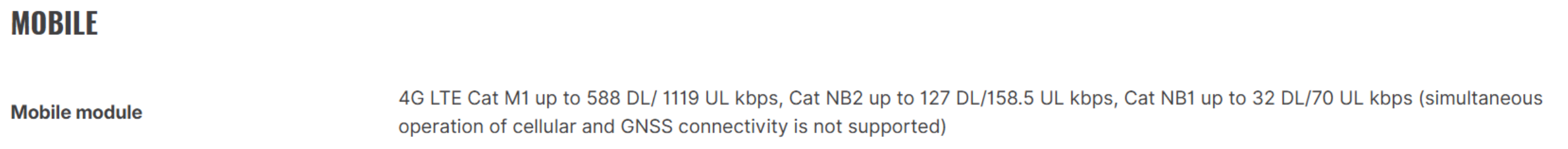

This behavior is expected and inherent to the device’s design, which does not support simultaneous cellular and GNSS connectivity.
As a workaround, you may try enabling WWAN + GNSS mode in the GPS configuration settings (Services → GPS ). In this mode, the device connects to the GNSS system at predefined intervals. During these intervals, the mobile connection is temporarily disabled for a specified timeout period.

to Latest branch. 600/100 setting is in testing.

600/100 setting testing on Latest branch FW seems to have no issues.
System is having correct 100s timeout and switching back to Mobile Data with no issues with and without GPS signal (with signal fast fix and fast switch back to mobile data).
