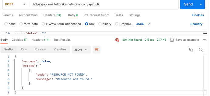

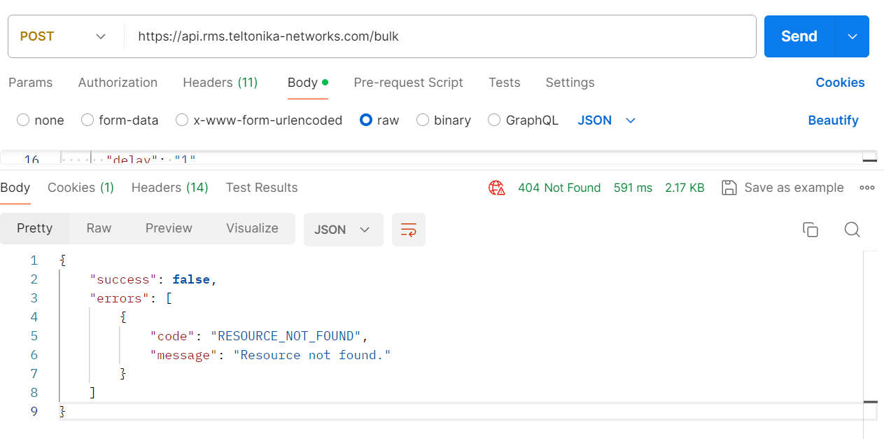

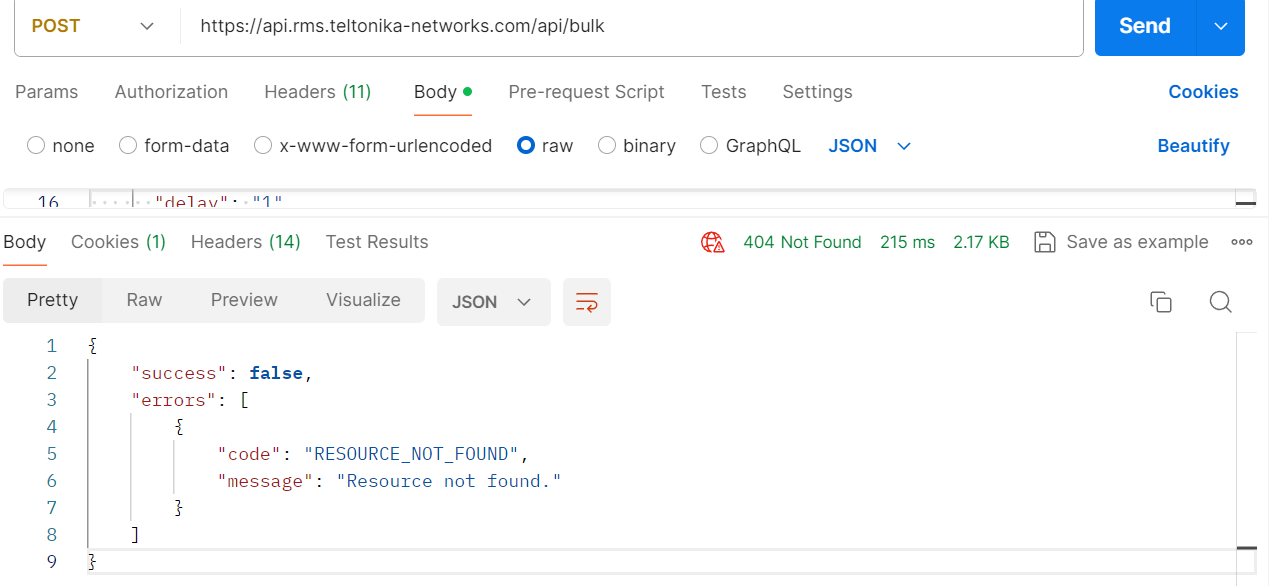

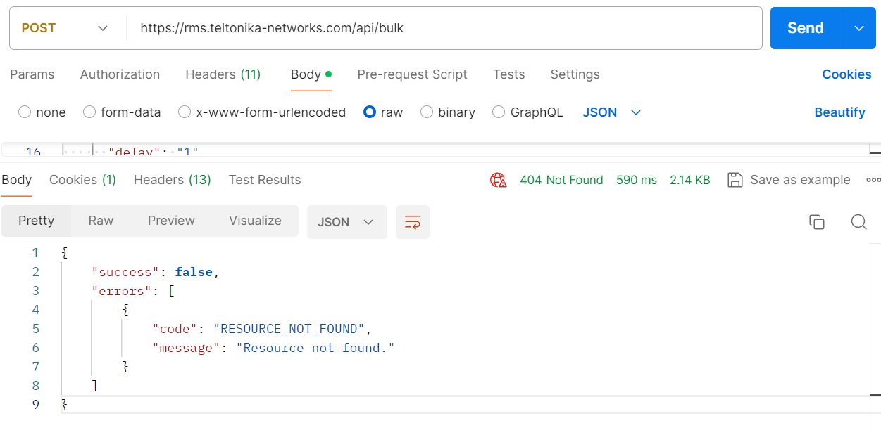

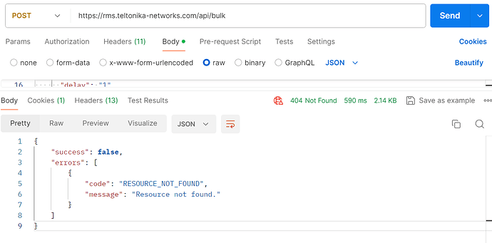

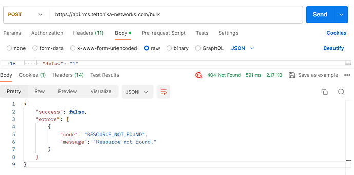

The Bulk API is returning a ‘Resource Not Found’ error. I’ve tried multiple URLs, but the error remains the same.
Do you have any updates on this?
Thank you for your patience.

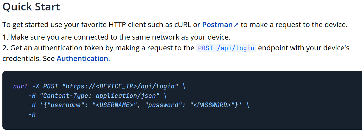

From the first view, the issue here is that you are using the RMS API, which has a different set of endpoints for API resources. The previously mentioned Bulk requests are not dedicated for RMS API. Instead, the endpoint for bulk requests should be:
POST https://<DEVICE_IP>/api/bulk
(assuming the authentication step has already been completed).
You can find more useful information in the REST API documentation here:
For RMS-specific API references, please check the documentation here:

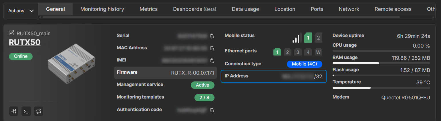

Where can I find the Public IP assigned to a device in RMS?
If your ISP has assigned a public IP to the device, you can view it by navigating to Management → Devices → Device details (required device) → General tab (see the screenshot below):

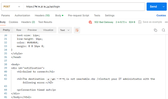

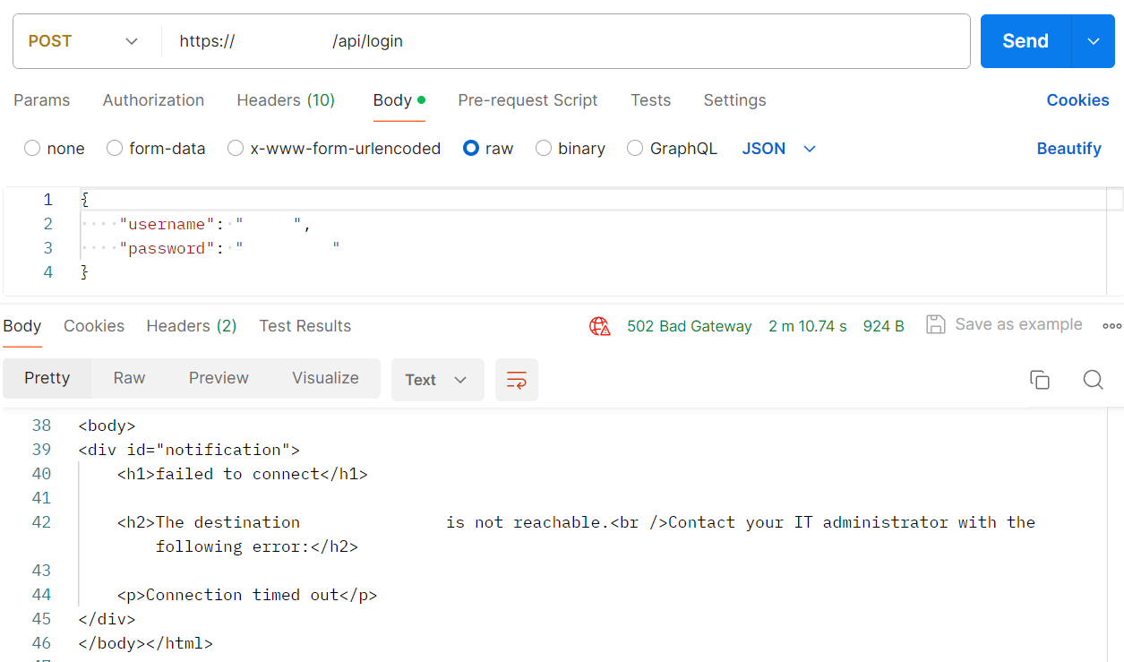

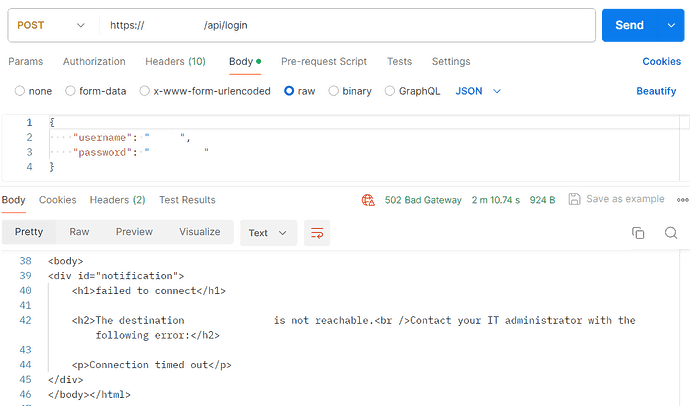

I obtained the device’s Public IP following your instructions. However, when I try to call the Authentication API using that IP, I receive an error stating: “The destination is not reachable.” Could you please help me troubleshoot this?

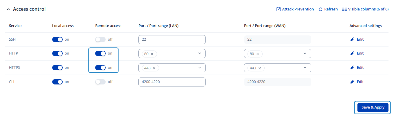

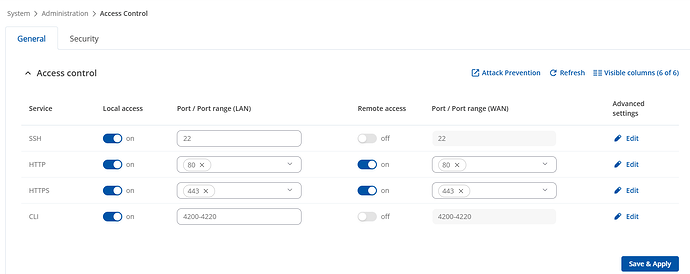

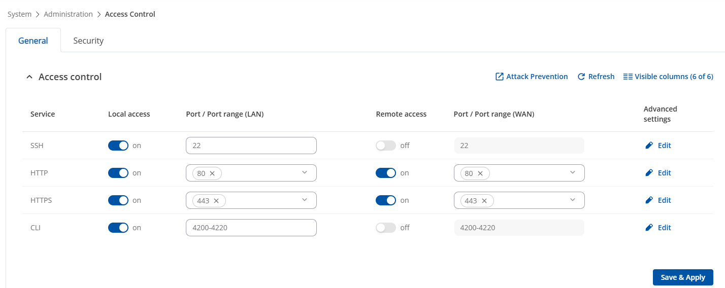

Can you check whether remote HTTP(S) access is enabled under System → Administration → Access Control page?
Also, ensure the login parameters (JSON) in the Body field are specified in correct syntax:
    "username":"admin",
    "password":"admin_password"
I followed your instructions by enabling and saving both HTTP and HTTPS remote access settings in RMS for the device, then called the Authentication API. However, I am still encountering the same error: “The destination is not reachable.
Can you confirm whether your device actually has a public IP assigned?
Have you tried running API calls when connected to the device locally (in LAN network)?
