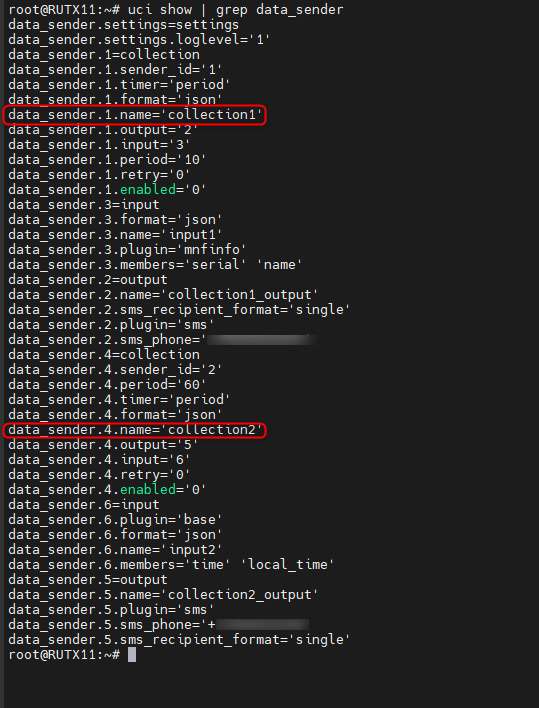

You can manually trigger or enable a Data to Server instance using UCI commands. To view all existing instances and their identifiers, run:
uci show | grep data_sender
You should see output similar to the example below, where the instance names are highlighted (e.g., data_sender.1, data_sender.2, etc.):

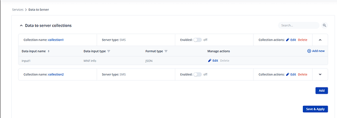

These same instances correspond to what you see in the WebUI under Services → Data to Server.

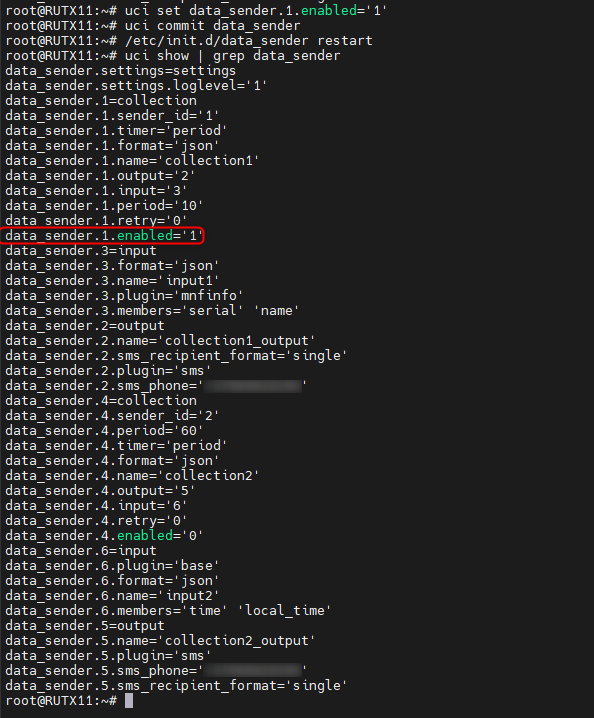

To enable a specific instance—for example, collection1 (which typically corresponds to data_sender.1)—use the following commands:
uci set data_sender.1.enabled='1'
uci commit data_sender
/etc/init.d/data_sender restart
After applying these commands, running the UCI show | grep data_sender again should show the instance with:
enabled=‘1’ means that the instance is enabled.
