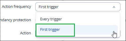

If you want to only be informed ONCE, in the “Services → Modbus → Modbus TCP Client → (edit) → Alarm Configuration → (edit)” menu, you can set “Action frequency” to “First trigger”:

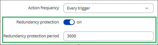

Alternatively, if you want to be informed periodically (e.g. once an hour), you can enable the “Redundancy protection” and set your own time period how often this alarm could be triggered:

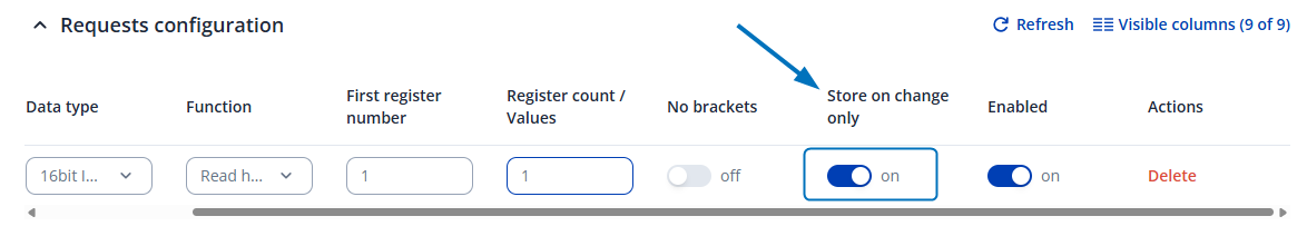

Could you please provide screenshots from your Modbus TCP client requests and the alarms configuration (with any sensitive information hidden)?
In your case, I’d recommend enabling the "Store on change only” option in the requests confirmation section:
This way, you should be able to set the action frequency to “Every trigger” so that the notification is sent only when the condition changes rather than continuously.
Let me know how it goes once you try this.
