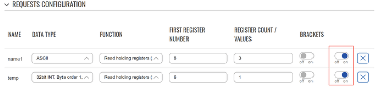

Have you enabled Modbus Master and Requests in the Modbus Serial Master?

I overlooked enabling each Request in the Modbus Serial Master. I thought that enabling Brackets would be enough:( You put it in a red frame, this was a warning for me. The data started to flow to the platform. Thank you very much for your help.
