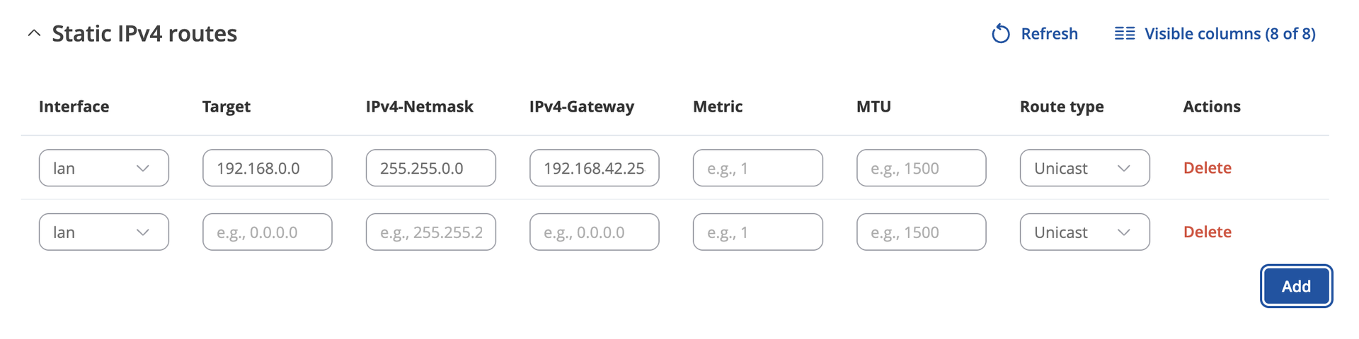

New device, no other config. I set a static address 192.168.42.101 to the RB160 on LAN and want to set a static route for 192.168.0.0/16 to the IP gateway 192.168.42.254. WAN/mobile is off.
I can add the route successfully:

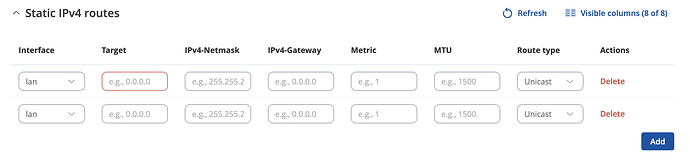

As soon as I hit “refresh” I get an empty entry

This looks suspicious the destination should be 192.168.0.0/24 and the netmask 255.255.255.0.
Uh, why? I have several subnetworks in 192.168.0.0/16 all reachable through 192.168.42.254 which is the gateway for 192.168.42.0/24 where I sit. I think it’s perfectly legal. Evidence: openwrt likes it. :slight_smile:

Oh, just realized it works perfectly in incognito mode.
I suppose I have the same set of extensions over multiple devices, so it must be one of them.
Sorry for the false alarm.
