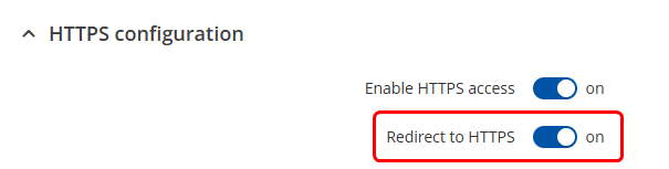

This is actually completely normal behaviour. Modern browsers default to HTTPS because it’s more secure, encrypting data to prevent interception and tampering. Features like HSTS and HTTPS-First Mode make browsers try https:// before http://, and many websites enforce HTTPS redirects themselves. This improves user safety drastically.
You may try to enable “Redirect to HTTPS” setting under System → Administration → Access Control → “Edit” on HTTPS to see if that improves the situation.
Brilliant, disabling that redirect actually solved my issue! Thanks, Mat
