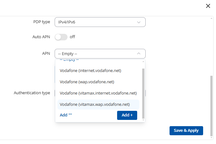

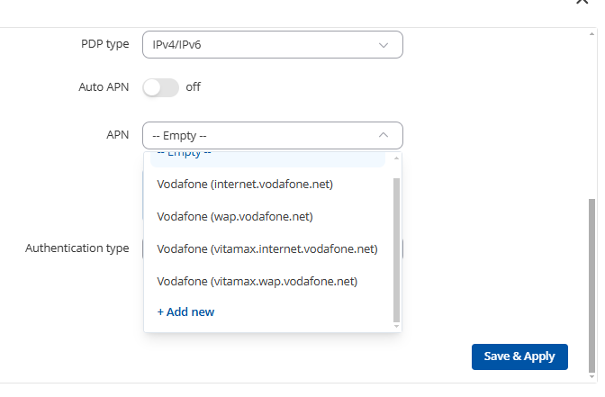

TRB145: not able to set custom APN
I have been using TRB145-s with private APN-s since a couple of years now, so I know how to set them up. But with the latest firmwares, I am not able to enter the name of the private APN. I set Auto APN to off, go to the APN list, I push “+ Add new”, but it only displays Add"" and a button, and it does not allow to actually enter the name of the APN. What do I do wrong?

Here are the screenshots:
When you press on image icon, it should allow you to type your APN manually in the field instantly, as shown in the following screenshot (1):
After entering the APN, press Add (2), and your custom APN will appear in the APN field.
Don’t forget to click Save & Apply to save the changes.
Let me know if you need further assistance!
Thanks, there was a problem with my browser, now it works.
