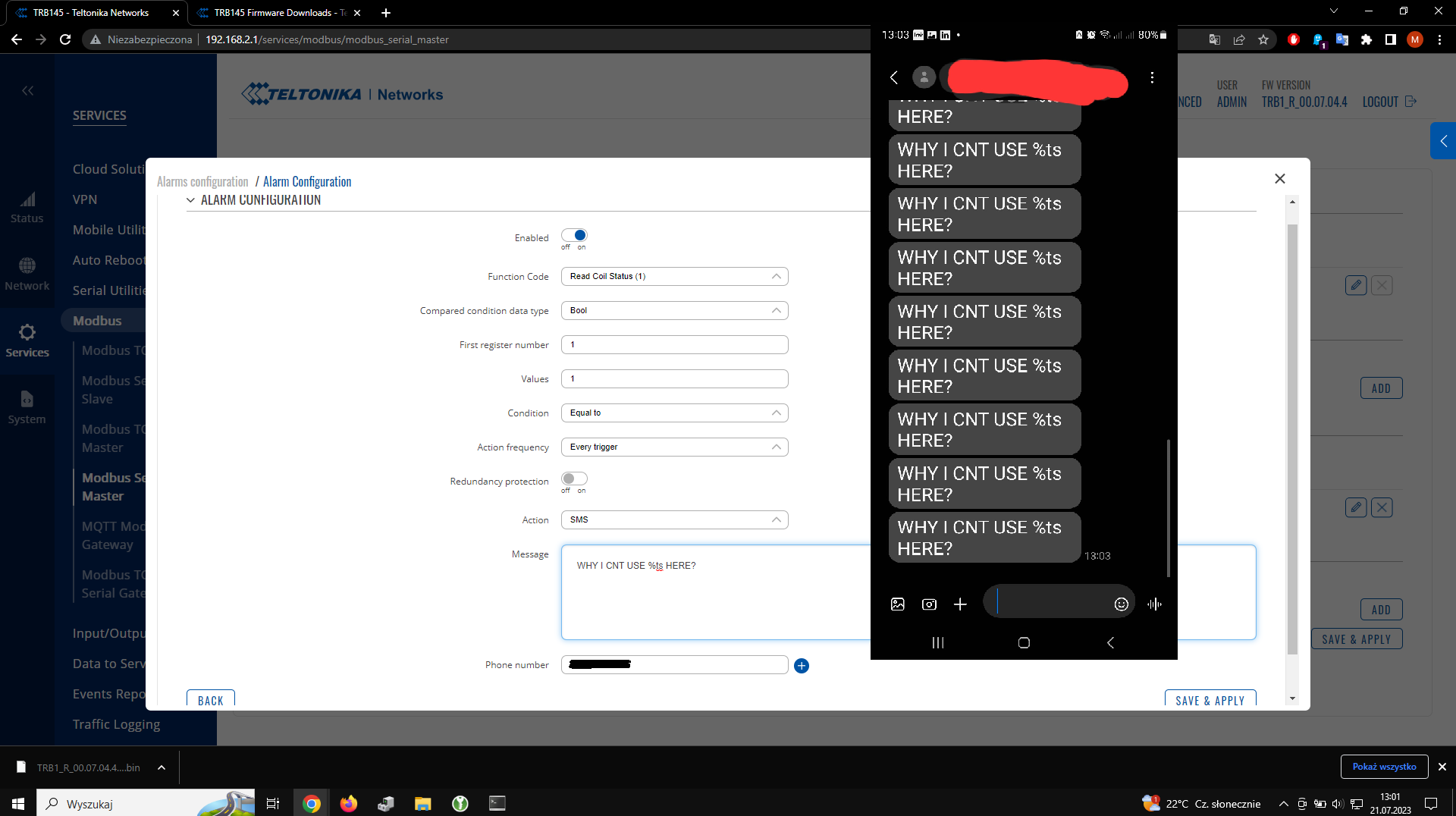

TRB145 - Modbus Serial Master and Alarms via SMS
Is it possible to use a timestamp in an SMS message sent by an event triggered by a condition being met when reading registers using modbus serial master from a modbus slave device? (Services->Modbus Serial Master-> Modbus Slave Configuration->Alarms Configuration->Action->SMS)
And why is not?
Can I get this functionality somehow?
Next question:
How can I create more complex alarm conditions? eg: 30<x<=100
(Services->Modbus Serial Master-> Modbus Slave Configuration->Alarms Configuration->Condition)
And last:
Why i cant use defined “phone group” in ALARMS CONFIGURATION (Services->Modbus Serial Master-> Modbus Slave Configuration->Alarms Configuration->Action->SMS)
