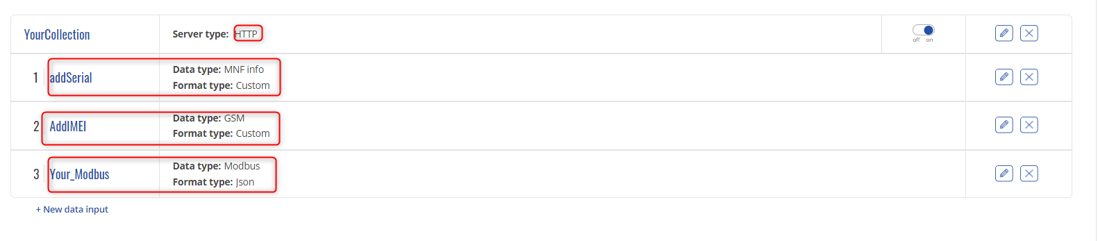

This should be possible with the new v7.05.4 firmware. Please, update the device to the last with ‘keep settings’ option disabled. You will have to reconfigure the device.
Configure Modbus and ensure that you can read the data from your Modbus slave device using the Test button. Once that is done, you can configure the Data to Server service to send this data to your API via HTTP. In data to server, you will need to add three data types - MNF source with serial number, GSM source with IMEI number, and third input with Modbus data. All of these sources will be included and sent to the server defined in your collection. So the collection could look like this:
