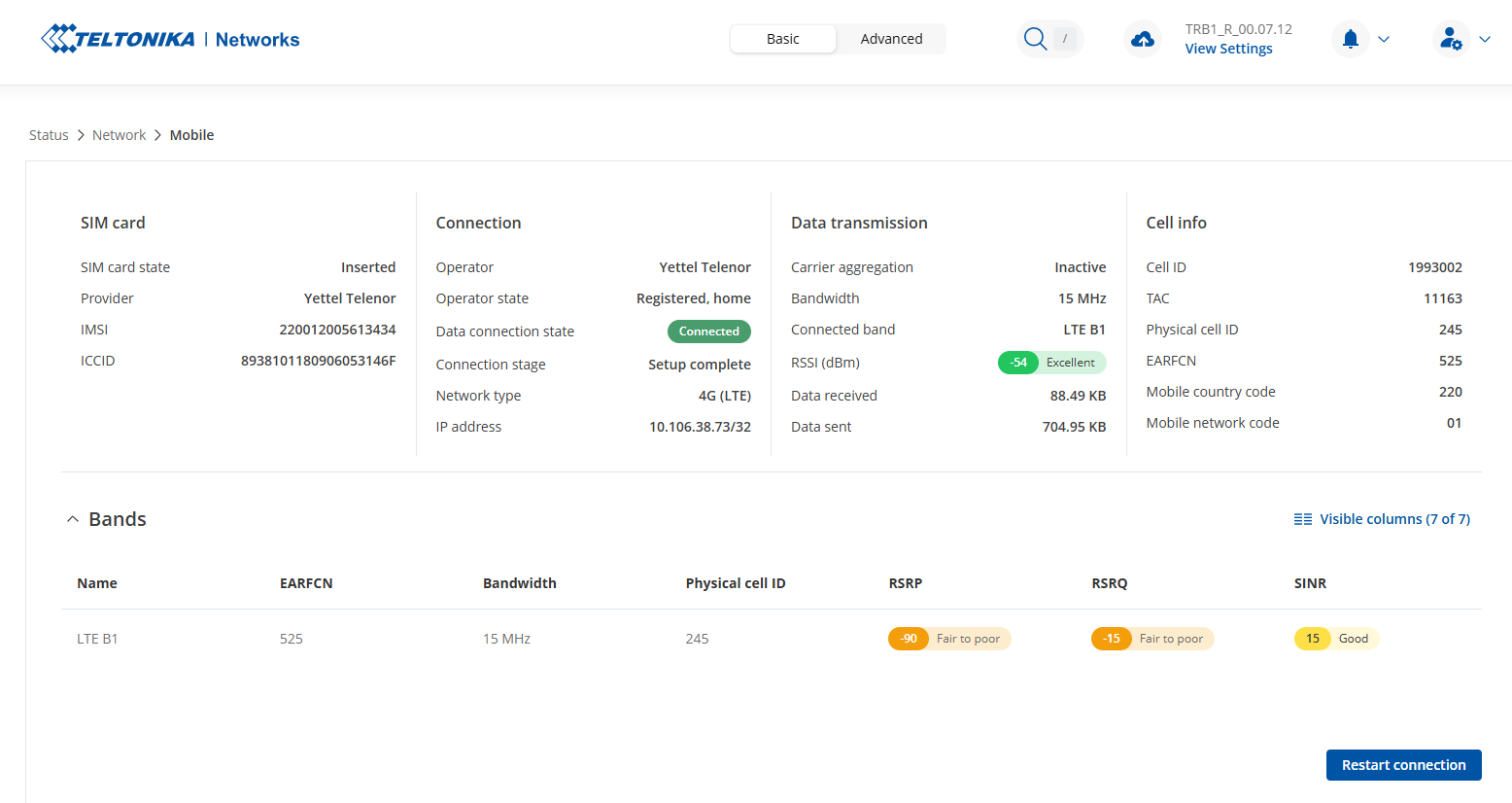

Could you please navigate to StatusNetworkMobile in the WebUI and attach a screenshot of that page here?
Thank you.
Thanks for the reply!
As you can see, the signal strength is Fair to Poor, which is most likely causing connectivity issues. You can find our signal strength recommendations here: Mobile Signal Strength Recommendations.
I recommend moving closer to a mobile tower to improve the signal and checking if the issue persists. Additionally, please ensure that the mobile antenna is properly connected at a 90-degree angle.
Lastly, make sure your SIM card has an active plan.
