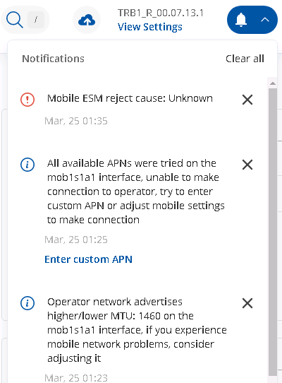

I applied the latest firmware which seems to have fixed some bugs I noticed in the log, ie the unclean reboot, but now every 2 minutes and 17 seconds the 4G connection seems to reset and go down. The signal strength is good right up until the 2:17 when the interface disconnects and reconnects. It seems like it’s the device itself which is just resetting the interface according to some timer.

Could you please let me know if you’ve tried changing the MTU size as suggested in the notification from the WebUI?
If not, please give it a try and let me know if it helps resolve the issue.
Correct. I turned off Auto MTU and change it down manually but it fails and comes up with a lower MTU so I change it down and it fails and comes up with another MTU which can be lower again or higher than the MTU, like a yo-yo. Nothing i set seems to stabilise it.
