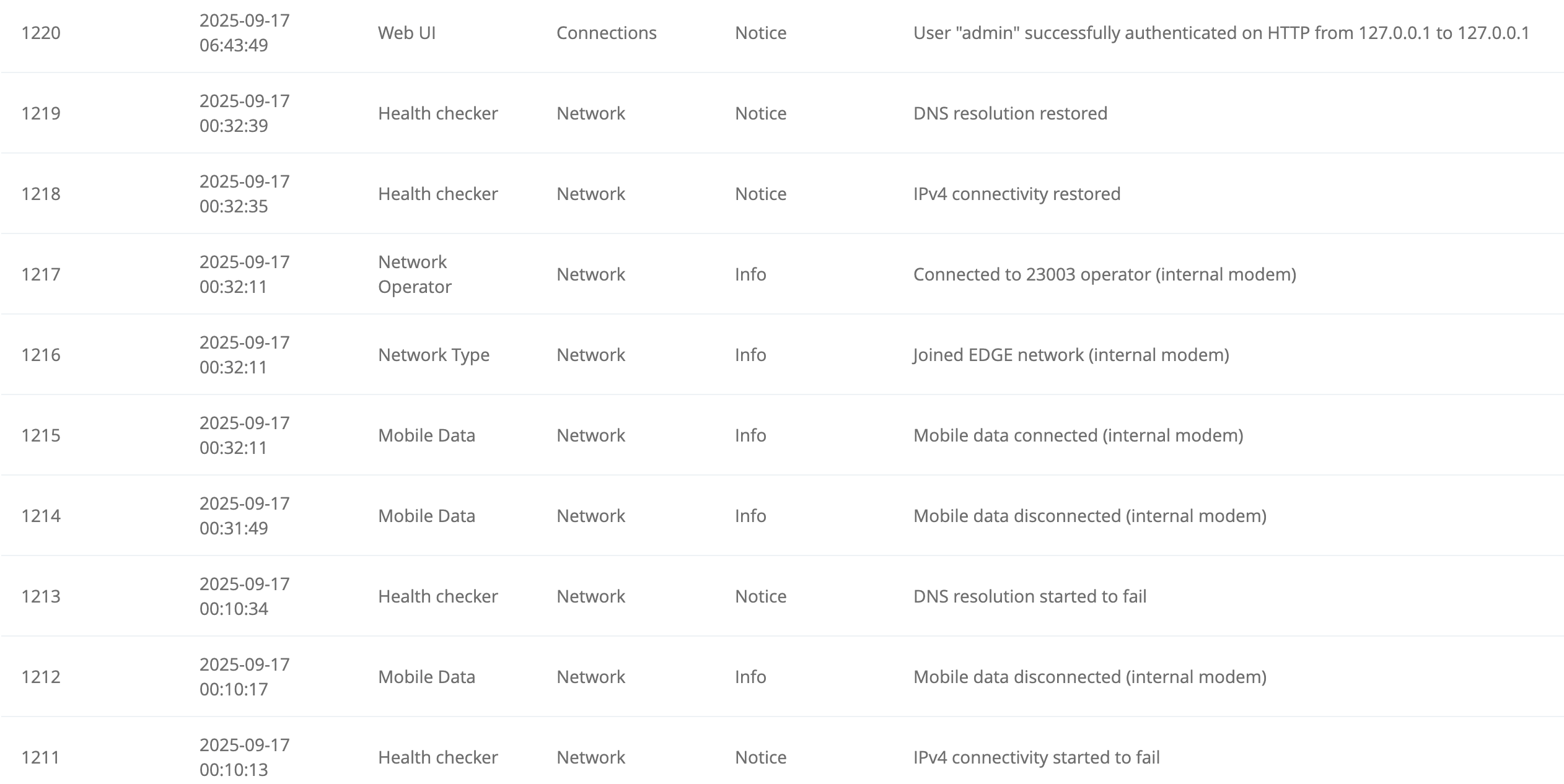

there is event log: (last signal i got from 0:32… but state never changed from this time)
