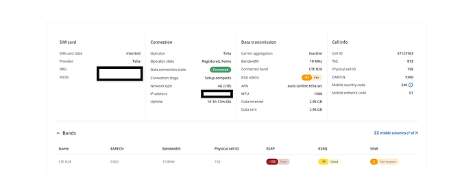

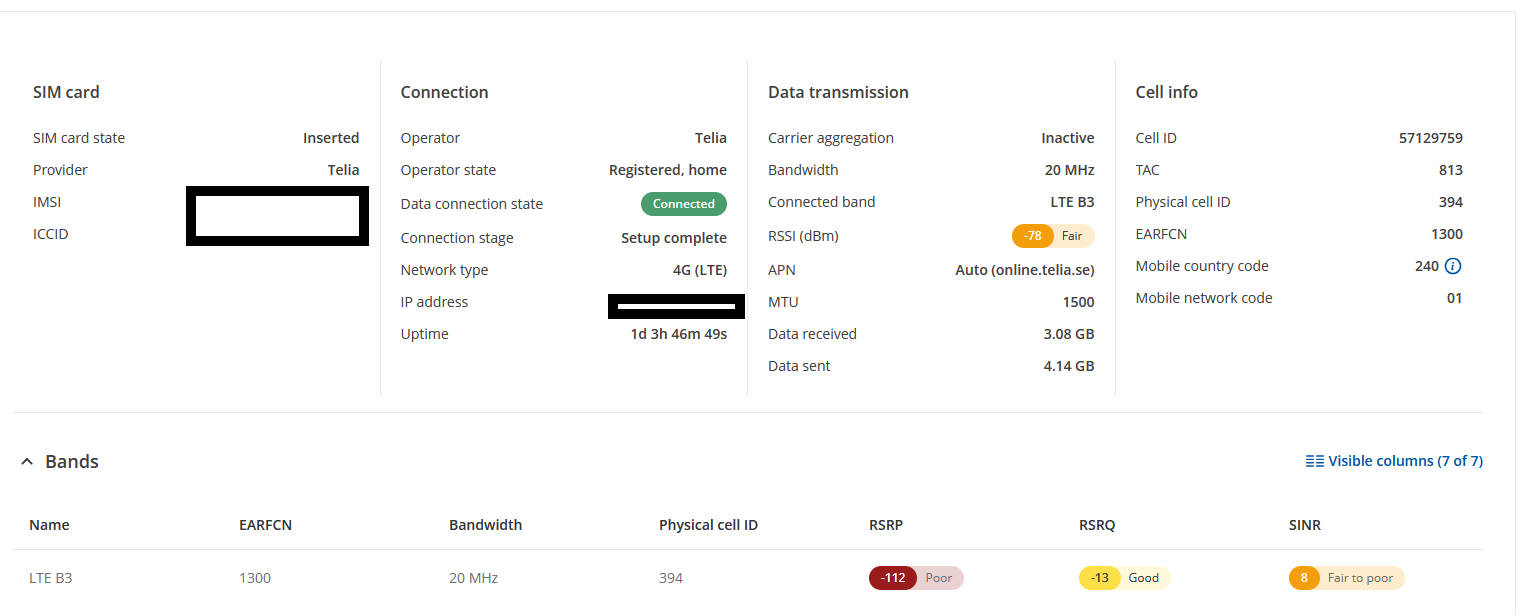

I’ll reach out to our R&D in regards to the excessive data usage and will get back to you once I have an answer.
Could you clarify what is your QoS option set to on both of the devices, and what signal strengths are you getting on both of the devices? The QoS settings can be found under the action data configuration: TRB141 Event Juggler - Teltonika Networks Wiki
Signal strengths can be found under Status → Network → Mobile (please blur out any sensitive information such as IMEI, your Public IP address, IMSI, ICCID, etc).
Tanks!
QoS is set to 0 for the analogue input (which is sent every 5 minutes), for the two relays it is set to 1 (at least once) since they are two alarms and it is important that they are transmitted securely. The alarms do not trigger often, so far it has only happened when we manually triggered them during testing.
Reception isn’t the greatest but decent considering that they are placed in basements.
/EDIT - the TRB143 is set to QoS 0.
Thanks for clarifying the information. For troubleshooting purposes, we will require more sensitive information from your end, such as the troubleshoot file, which may contain passwords, public IP addresses, serial numbers, and such. To avoid leaking this information, we have sent you a form to fill out, which you will receive in your e-mail inbox that you have registered your account with in the forums. In the Ticket ID field of the form, please enter the ID of this thread, which is 15084.
