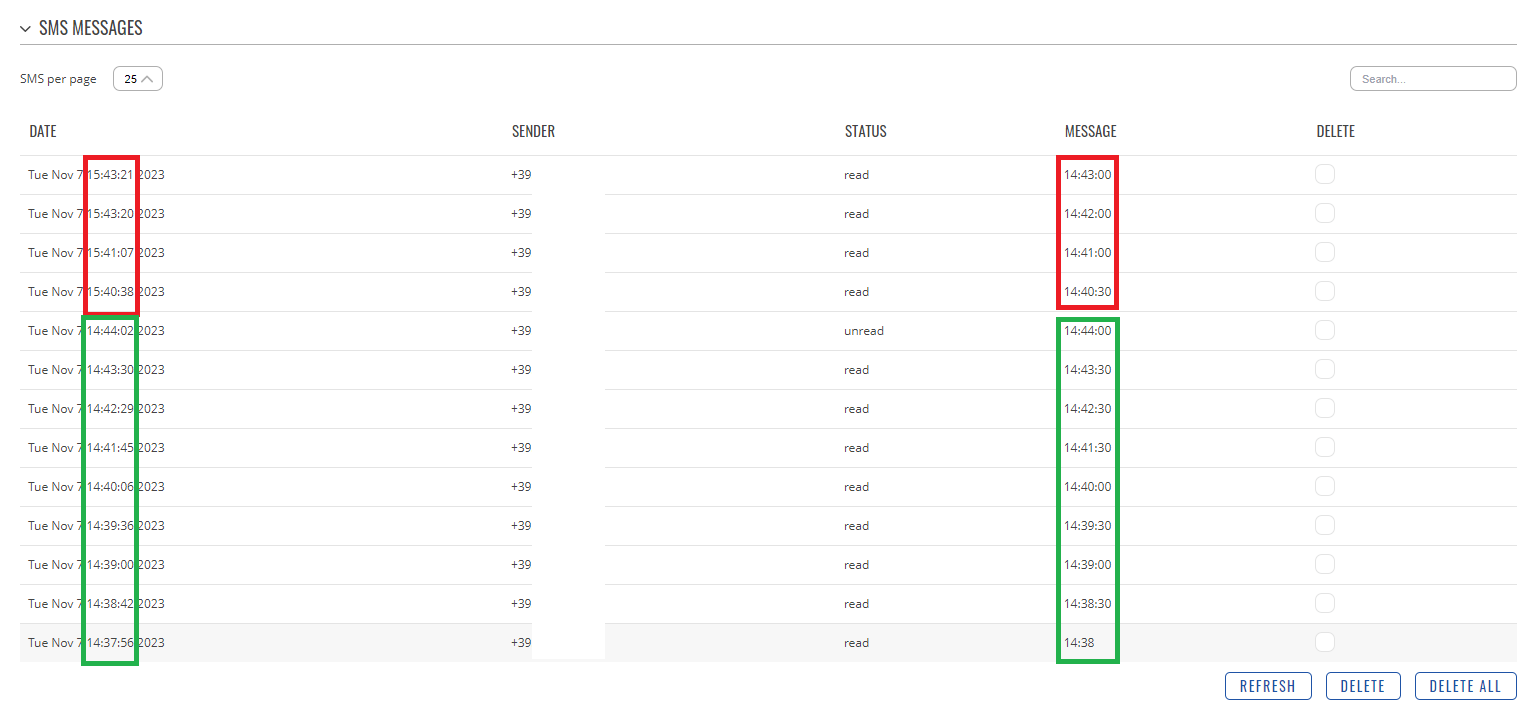

Yesterday we try to send 13 SMS to TRB140 and in the TEXT Message we have wrote the time. All the sms was received in real time with no problem or delay, but 9 sms was received and the TIME is correct, and 4 sms was received with TIME +1.
View the image TRB140.png:

Could you please clarify if you have received the last 4 SMS messages after one hour, or is this issue simply visual? I.e. your received the messages at 14:40:38, but it shows 15:40:38?
Good morning Andzej, the issue is “simply” visual (but not so simple).
Because the sms sent at 14:40:38 was riceived at 14:40:40 but on the interface (and on the web service) it show 15:40:38.
This is not good if we want save the message raw in SQL, because the sms’s informations are wrong.
