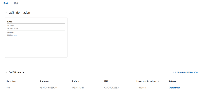

Thanks, I followed the instruction but still no internet connection. I can see my device in my router at IP: 192.168.1.109
My STATUS → LAN looks as follows

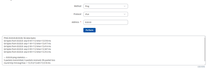

and my troubleshooting ping as follows:
Looking at the screenshot, it looks like you have an internet connection, but that, I assume is from the SIM card that you have inserted?

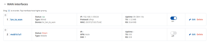

If you want to primarily use your WWAN interface as the internet source, I would suggest going to Network → WAN and drag the WAN interface be above the mob1a1s1 interface, more information here: TRB140 WAN - Teltonika Networks Wiki
Additionally, since TRBxxx devices don’t have failover functionality, your primary interface will be the one that the traffic goes through, however, both of them will be active. Once, let’s say, the WAN interface goes down and the mobile stays, the traffic will then go through the mobile.
I haven’t got a SIM card inserted. I try to do a firmware update and it says “no internet connection”. I have the WAN on top
Please try changing your LAN IP address to 192.168.2.1 (or any other that isn’t the 1.0 subnet) and try testing again. There currently seems to be a conflict.
That did it, thanks alot!
