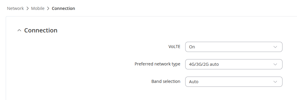

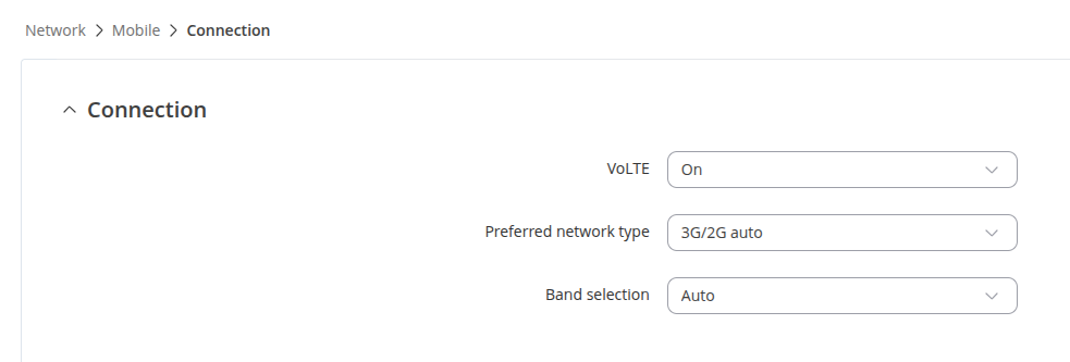

I changed Preferred network type = 3G/2G auto and it seems to work now. It seems that after the firmware update it was automatically set to 4G/3G/2G auto and with these settings it seems not to work.
Is there any limitation of the TRB140 device for 4G? I ask because the GSM provider also supports 5G so theoretically it should work with 4G too, right?
Hello
Theoretically, the device should be able to send SMS over the 4G network as well, provided that VoLTE is enabled. Could you please confirm whether VoLTE (Network → Mobile → Connection) was enabled?

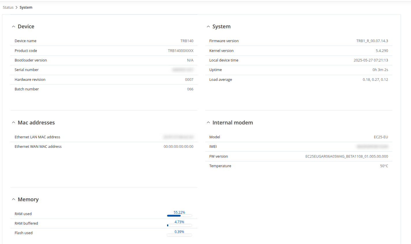

Additionally, if possible, could you please provide:
  • The internal modem details from the Status → System page;
  • The output of the gsmctl -D -S -s "+<number> test" SMS sending command.

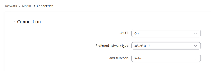

With these settings it’s working (3G/2G):
admin@TRB140:~$ gsmctl -D -S -s “+40760274974 test”
GSMCTL modem[0]: Debug mode enabled
GSMCTL Modem id: 0
GSMCTL modem[0]: Calling Send SMS
GSMCTL modem[0] SMS: Checking input format
GSMCTL modem[0] SMS: Calling LGSM SEND SMS
GSMCTL modem[0] SMS: Checking called SMS send response label
SMS sent: 1
But, if I switch to 4G is not working:
GSMCTL Modem id: 0
[gsmctl_send_sms:22] error: ERROR: Failed to parse response
/status/system
