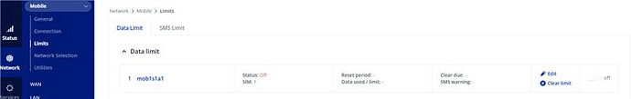

The TRB140 has a ‘data limits’ feature, which appears to measure traffic on the WAN interface (mob1s1a1), and does appear to have the ability to send an SMS based on a data usage threshold. I’m thinking that I could:
  • Insert the new SIM
  • Change the Data Limit to whatever the SIM has pre-loaded
  • Set the threshold to say 80%
  • Then, click the Clear Collected Data button.

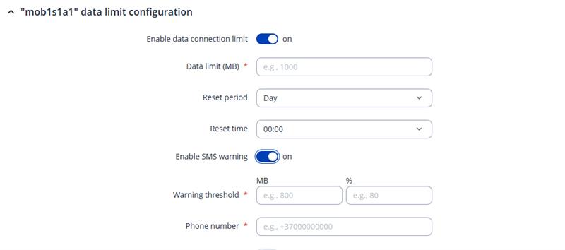

To enable the data limits feature via device WEBUI, please follow these steps:

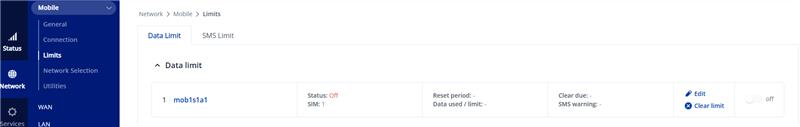

  1. Go to Network > Mobile > Limits.
  2. Click the Edit button.
  3. Enable Data Connection Limit and SMS Warning.
  4. Set your Warning Threshold. In your case, 80% of 24 GB equals 19.2 GB. (Please note: the threshold is entered in MB, not GB.)
  5. Enter your phone number in the field provided below the threshold.
Once these settings are configured, you will receive alerts when your data usage reaches the specified limit.

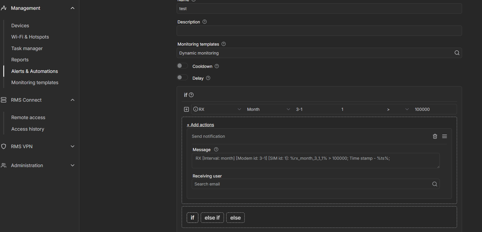

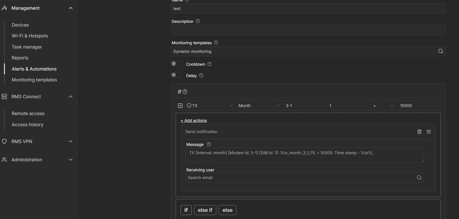

If you would like to receive notifications about your data usage, you can set this up in RMS by going to >Management > Alerts & Automations.With RMS, notifications will be sent to you via email instead of SMS.
Please note that this is just an example, so you may need to adjust the values based on your specific needs.[image]

If I am reading your response correctly, it looks like you are setting up two alerts, one triggering when RX is greater than an arbitrary value, and a similar one for TX. Queries:
  • The SIM card data allocation make no distinction between TX & RX, only total data. Does RMS have such a ‘total data’ measurement, or does it have the ability to sum RX & TX?

As a workaround, I’ll use the TRB140 WebUI Limit, but I would like to further discover whether RMS can provide a solution.

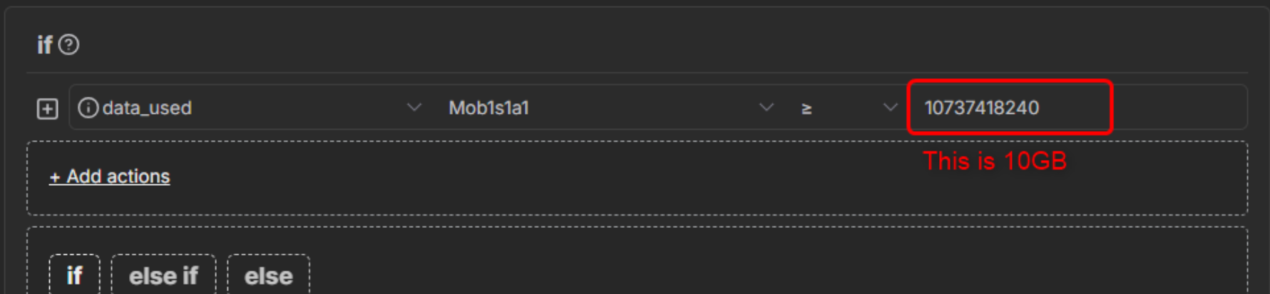

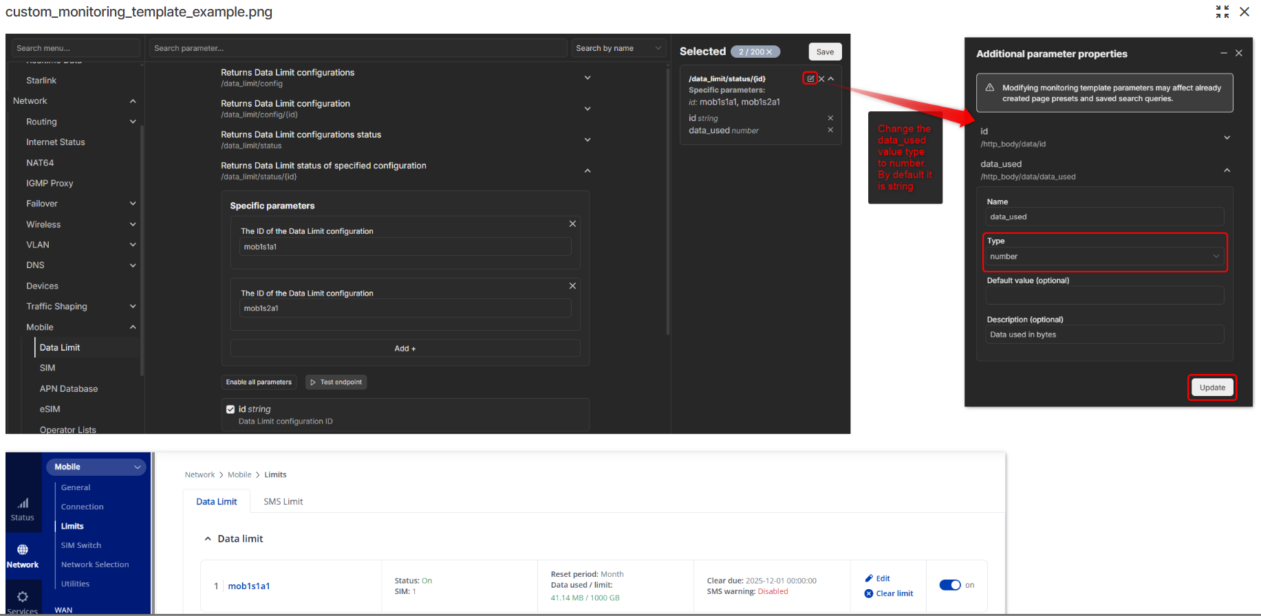

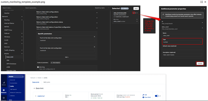

When it comes to RMS alerts, at the moment, it is possible to set alerts for sent and received values separately. However, when it comes to the sum of these values, currently, RMS monitoring templates cannot do math. While the send and receive parameters can be symmetrical, sometimes you may receive 10GB and send only 5GB (or have another type of combination), resulting in a false-positive alert.
As a workaround, we would suggest using the data limit feature on the device itself and setting an incredibly big data limit (an artificial data limit). Then you would be able to monitor the data limit service using custom RMS monitoring templates. Meanwhile, the data limit service can combine sent and received values. The data limit service can also automatically reset the data usage monthly.
Side note: Do not forget to set the correct values in the alert.
To learn more about custom monitoring templates, you can view this wiki page:
To learn more about the mobile data usage limit feature, you can view this wiki page:
