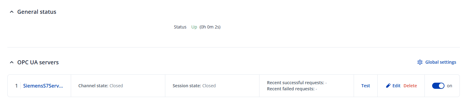

The TRB140 WebUI shows Channel State: Closed and Session State: Closed permanently, in a continuous retry loop.
