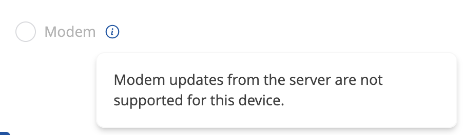

  2. Also, could you check if an update for the internal modem is available in the System → Firmware page?

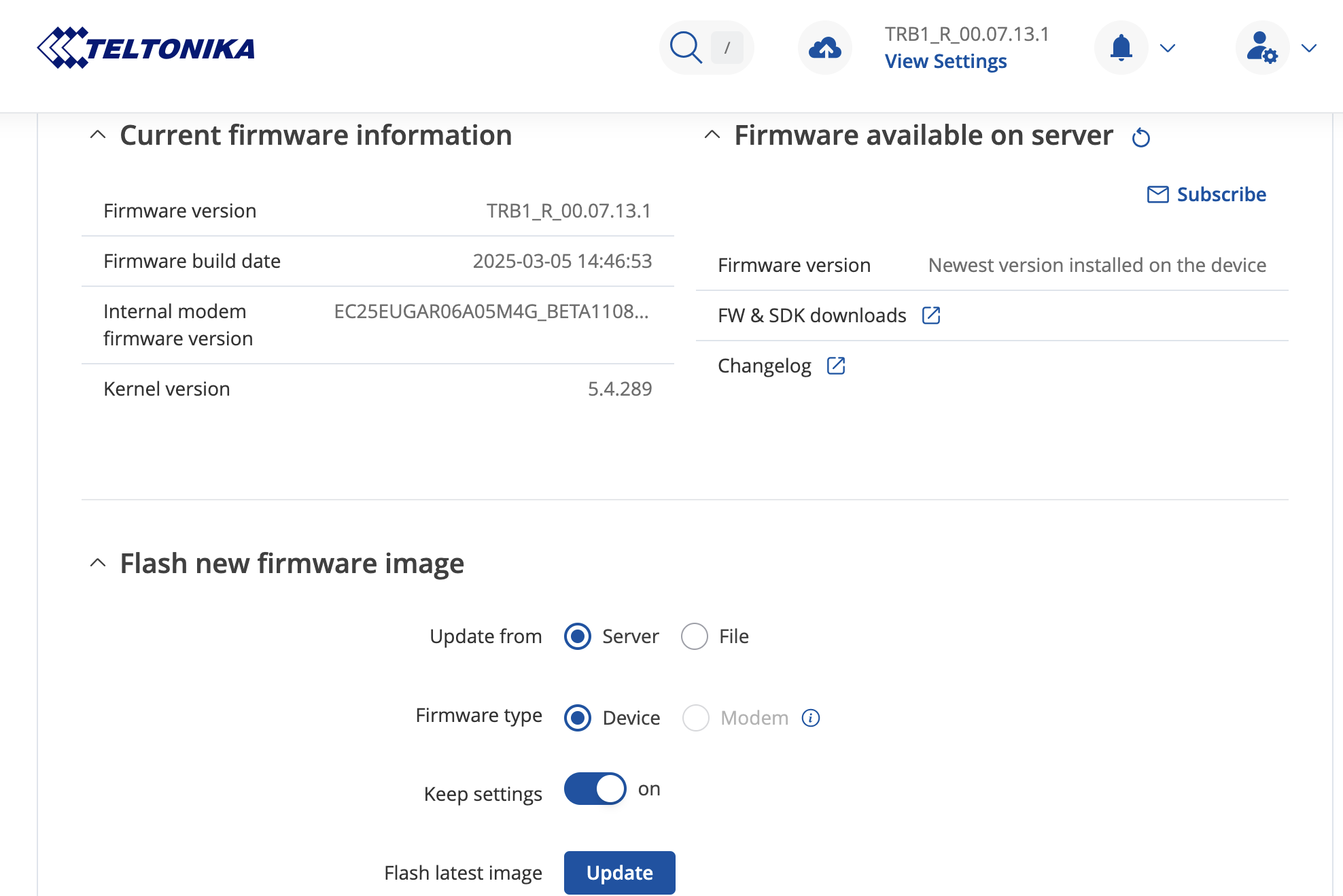

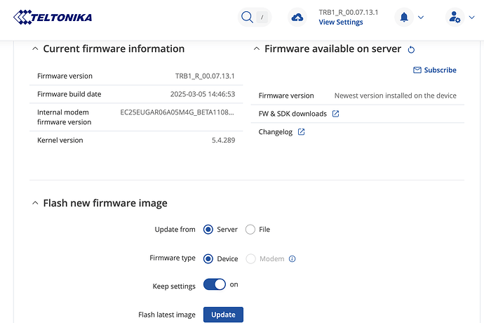

  1. I just wanted the latest version
  2. Capture enclosed

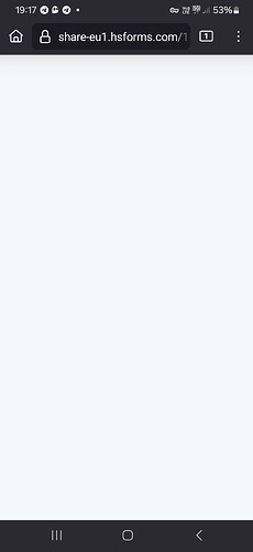

Apologies for a delay. Which browser are you using to open the form? Additionally, could you try opening it in an incognito window or on a mobile phone? Does it still display a blank page? Could you provide a screenshot of the shown blank page? Also, it doesn’t show any code or content in your given link.

Well I tried on my computer and on my phone.
I tried with VPN and without VPN
I tried normal mode and private mode in the browser.
Its always the same thing.
Blank page.
Browser is Firefox.
