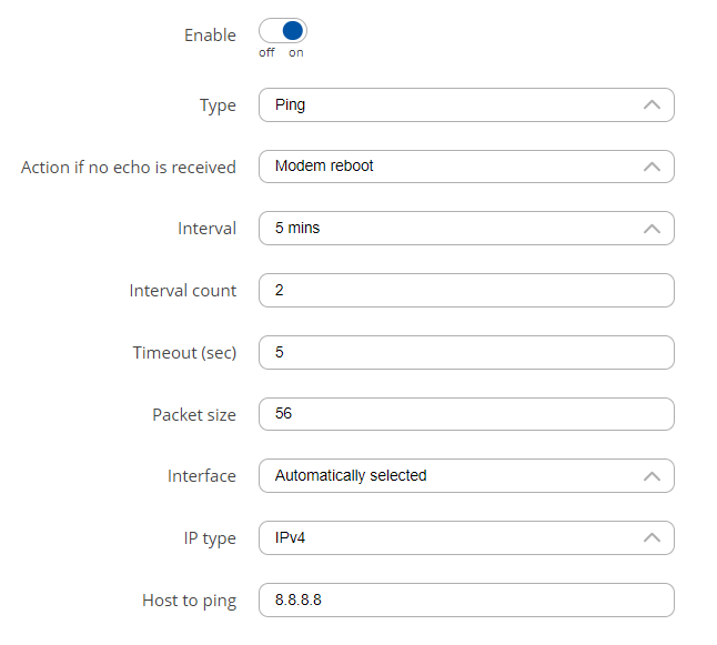

It seems like for some reason the TRB140 cannot obtain an IP address from your ISP. Could you try configuring a modem reboot in Services → Auto Reboot like so:
If the device still does not register, modem reboot can be changed to Device reboot.
Let me know if this helps.
