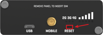

Since the reset button is not apparent within the WebUI, your best shot would be to opt for a reset via the physical reset button on the device:
If the reset button is pressed for at least 12 seconds (by default), the device will perform a factory reset and reboot.

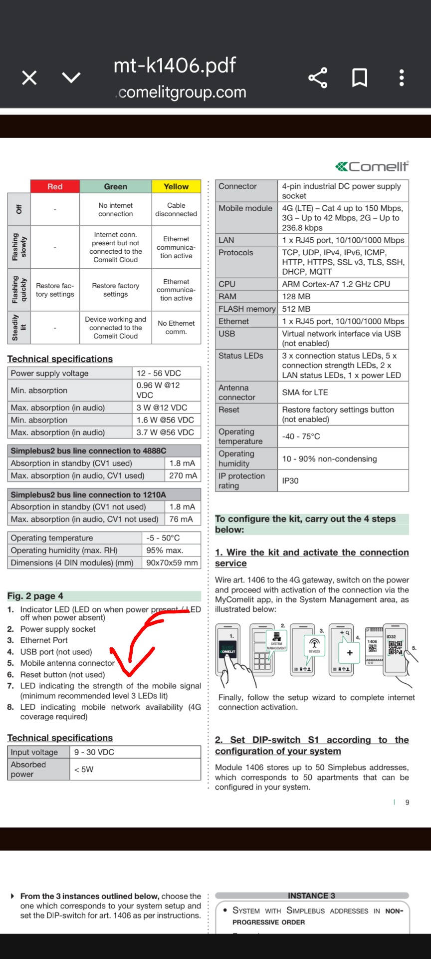

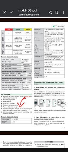

Yes it has an y send to you the documentation from art.1407 from Comelit which is trb140
