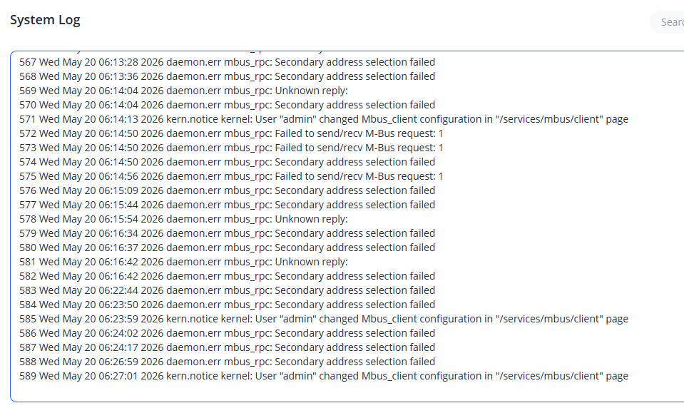

TRB 143 cannot scan for secondary address
I got a Flonidan M-bus Wireless to Wired converter and a PiiGAB HAN-P1 converter connected to the TRB-143 but I can’t scan for nodes and it also fails when I try to enter it manually.
Is there anyone who can help?
Both work when connected to Trb143 alone on the b-bus.

Hello, @WIESE ,
Sincerest apologies for a late response,
I have forwarded this information to our R&D team and I will inform you once I have an update on the matter.
