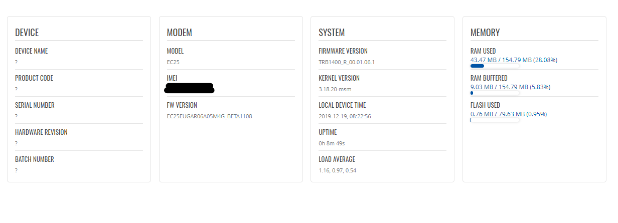

Can´t access through ethernet port, only microusb port. Device system information shows nothing:
DEVICE
DEVICE NAME
PRODUCT CODE
SERIAL NUMBER
HARDWARE REVISION
BATCH NUMBER
