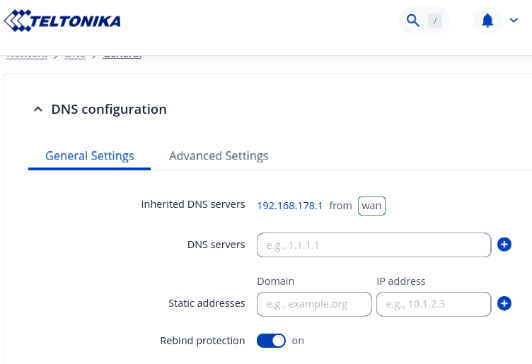

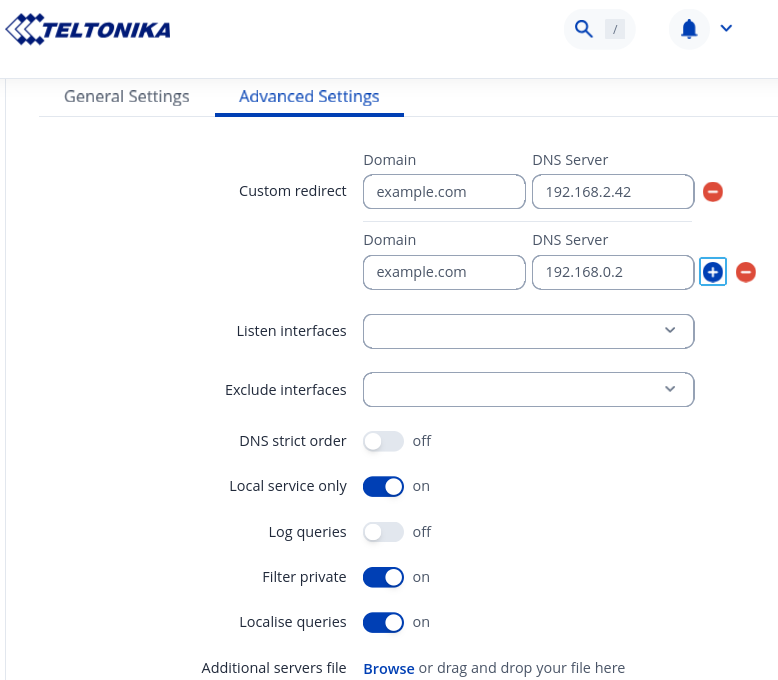

I am debugging a DNS issue where I have split DNS and my clients are getting back empty answers (answer section empty) for a query on the forwarded domain. Here is my sudo -u musictrace -i
(anonymized) DNS configuration:

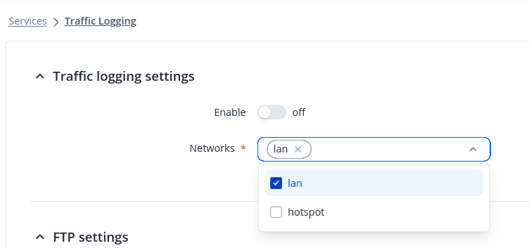

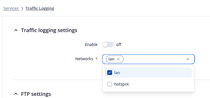

That being said, I’d love to be able to enable traffic logging on an OpenVPN tunnel.
How can I do that?

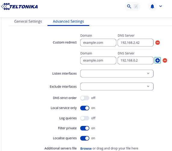

What is going on here? I tried playing with the settings on the “Advanced” Tab of the DNS configuration but that didn’t work.

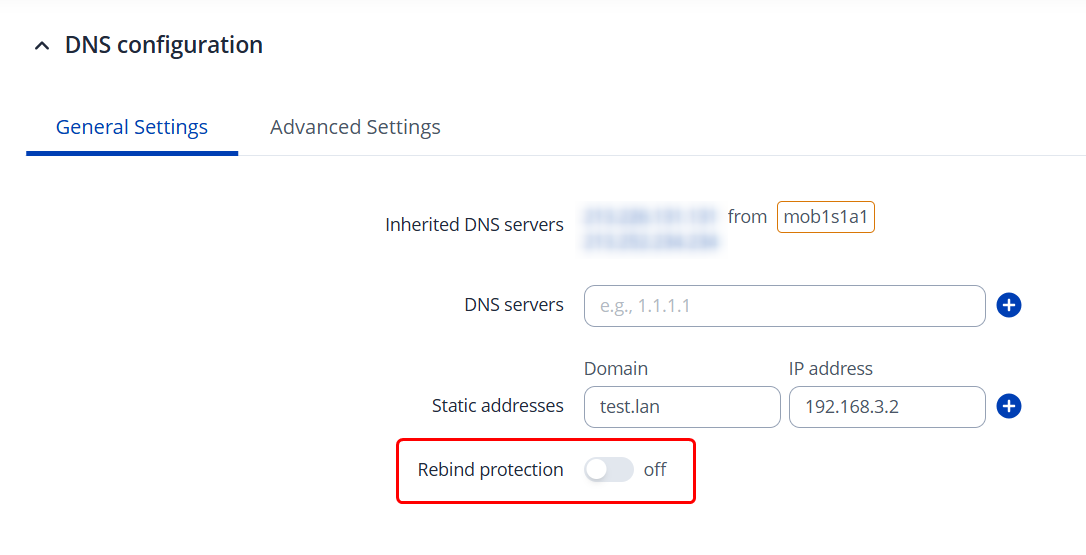

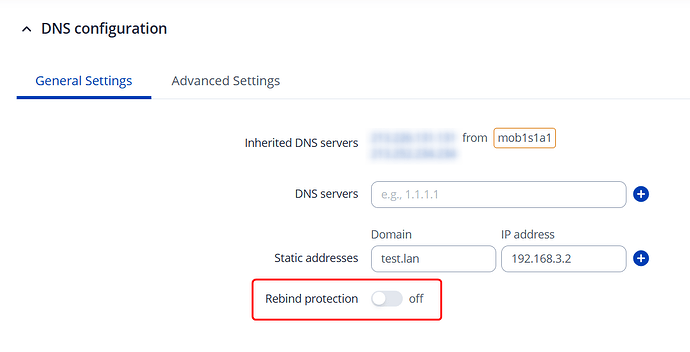

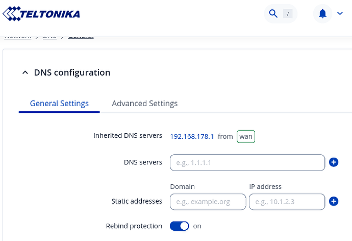

Could you first try to disable DNS Rebind protection under Network → DNS?
This allows dnsmasq to forward and return local/private IP answers (192.168.x.x, 10.x.x.x, etc.) for your split DNS domains.

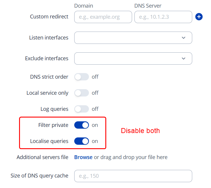

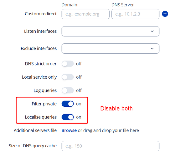

If that doesn’t help, please also try to disable Filter private and Localise queries under the advanced settings:
Disabling Rebind Protection did the thing. That was the one option I ruled out to interfere here and therefore I didn’t try. The hint to disable rebind protection when using custom redirects should go into the docs.
And, there should be a better method to log VPN traffic short of logging in to the CLI. That method is there for the lan, it should be available for all pysical and logical interfaces.
