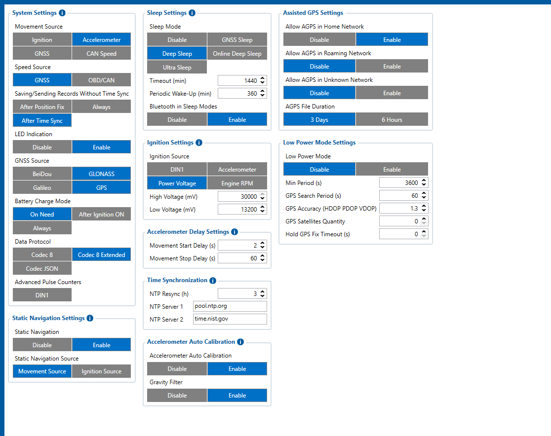

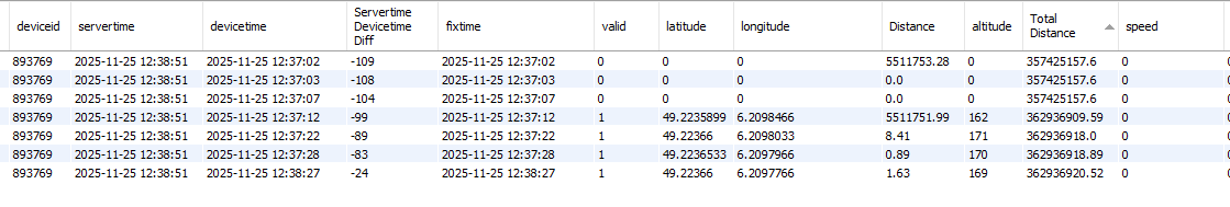

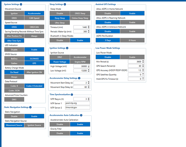

We are experiencing an issue with the evolution of the total distance on the FMC920 device. When we calculate the distance traveled over one week, we get approximately 55000 km,
which seems incorrect. Could you please check our configuration and help us resolve this issue?
there is an option that we can add to our config to allowus to remove the bad data ?
Thank you in advance for your assistance.

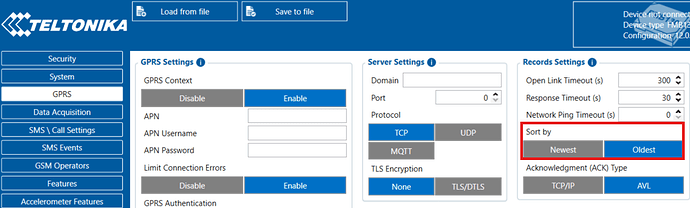

Good day! Could you check if the Sort By settings were set to Oldest? If not, kindly set it to Oldest and check again if the issue persists.
