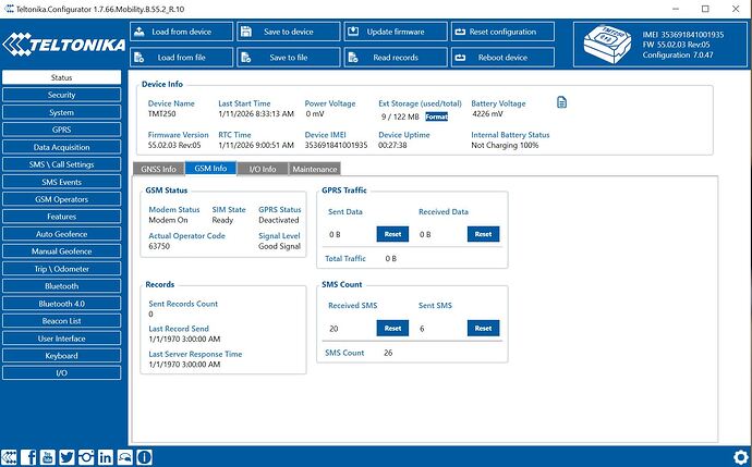

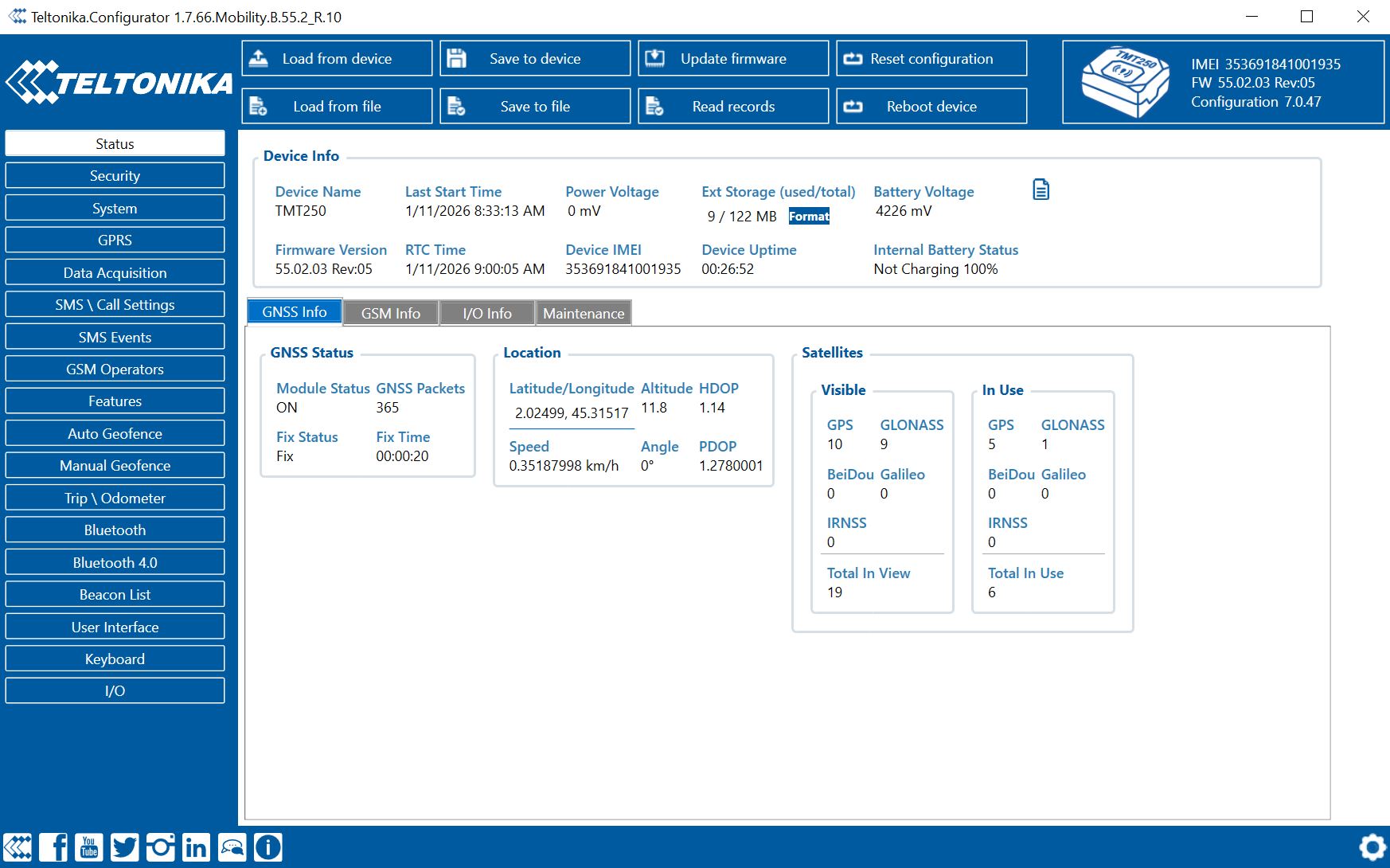

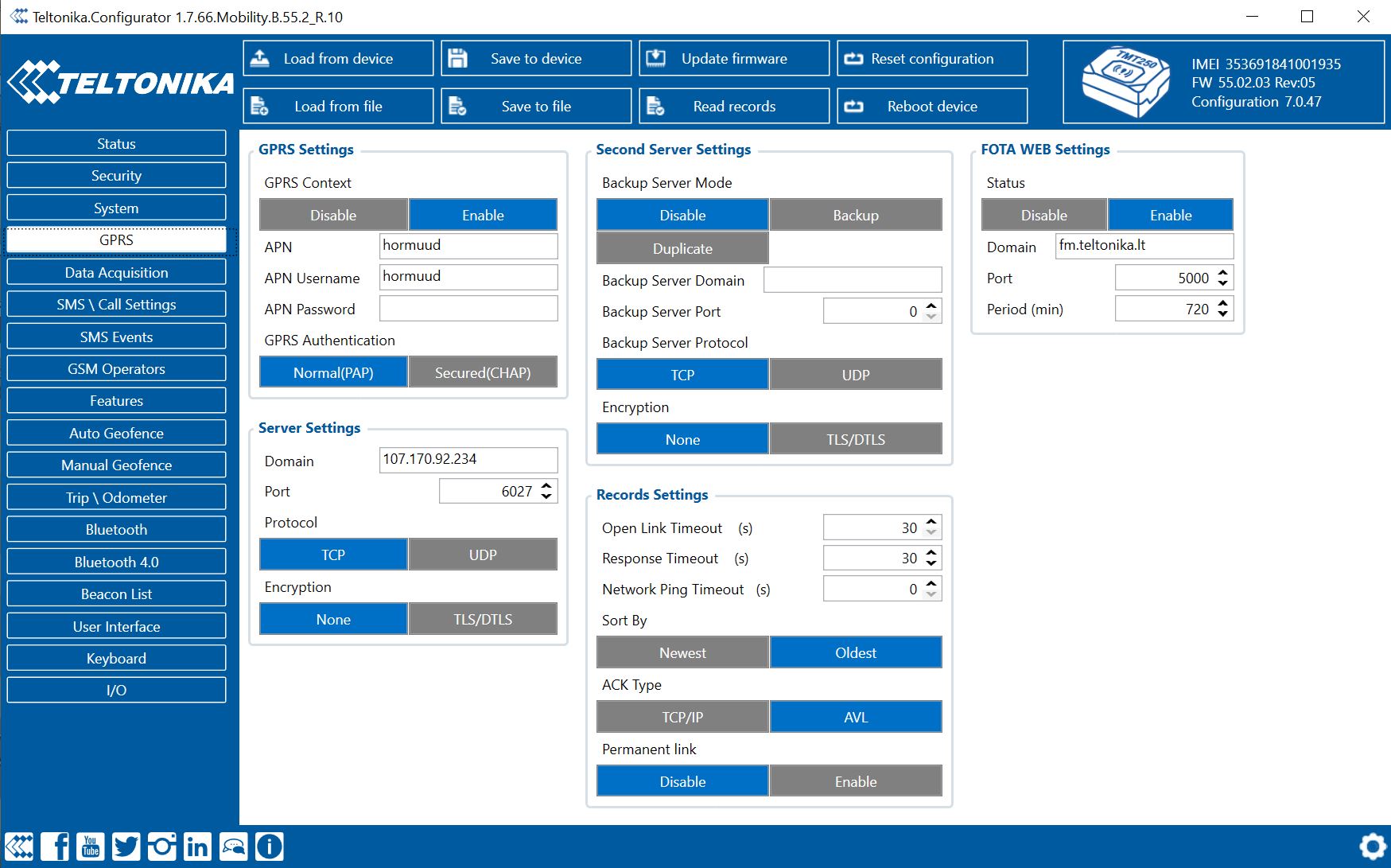

Hello everyone,
Could someone please offer some guidance? I have tested the SIM card with the data plan, and it appears to be working correctly. I have also confirmed the APN settings with my provider.
Despite these checks, I am still unable to activate GPRS and get it online on the GPSWOX Platform.
Please see attached. Thanks for anz advice.

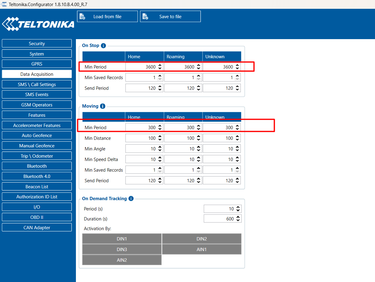

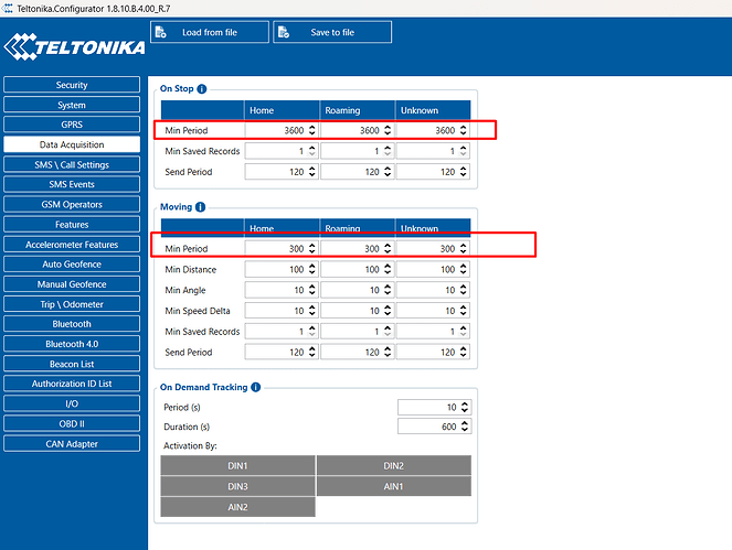

hello @JO911
you need to wait until the time of records generation
