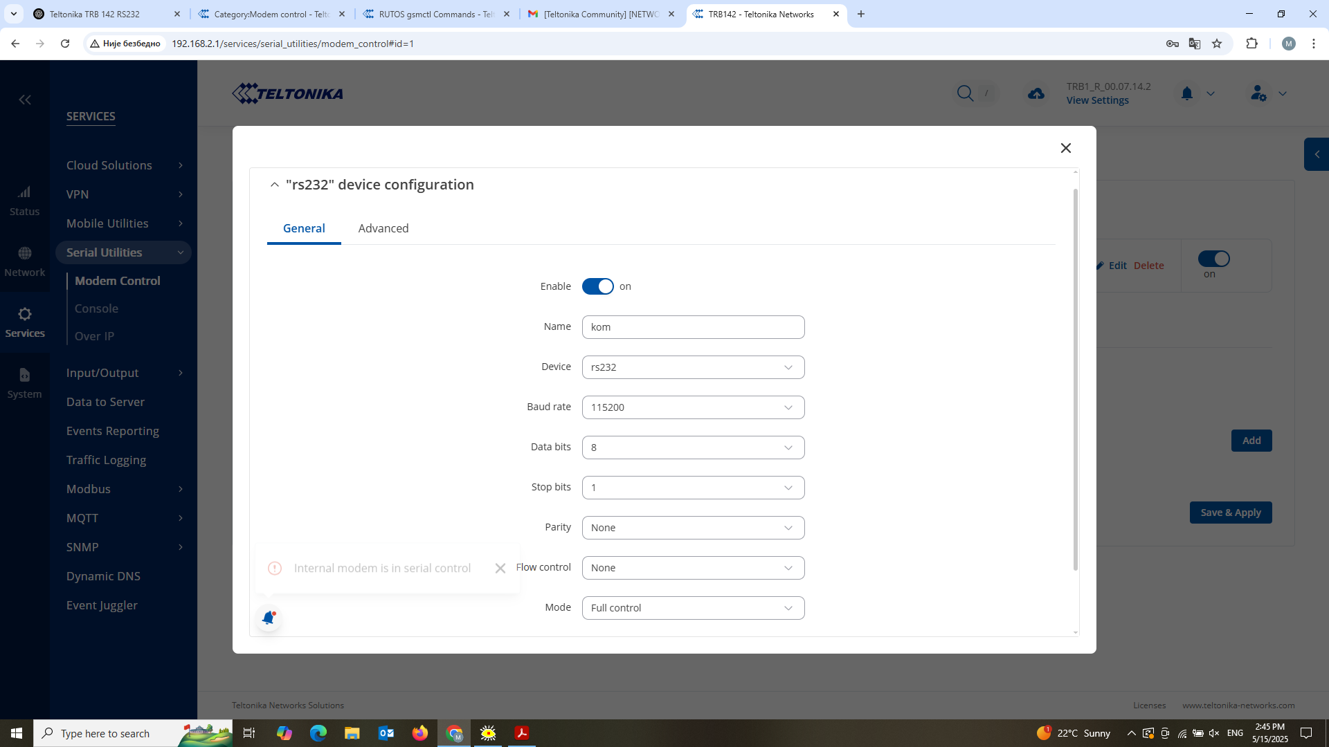

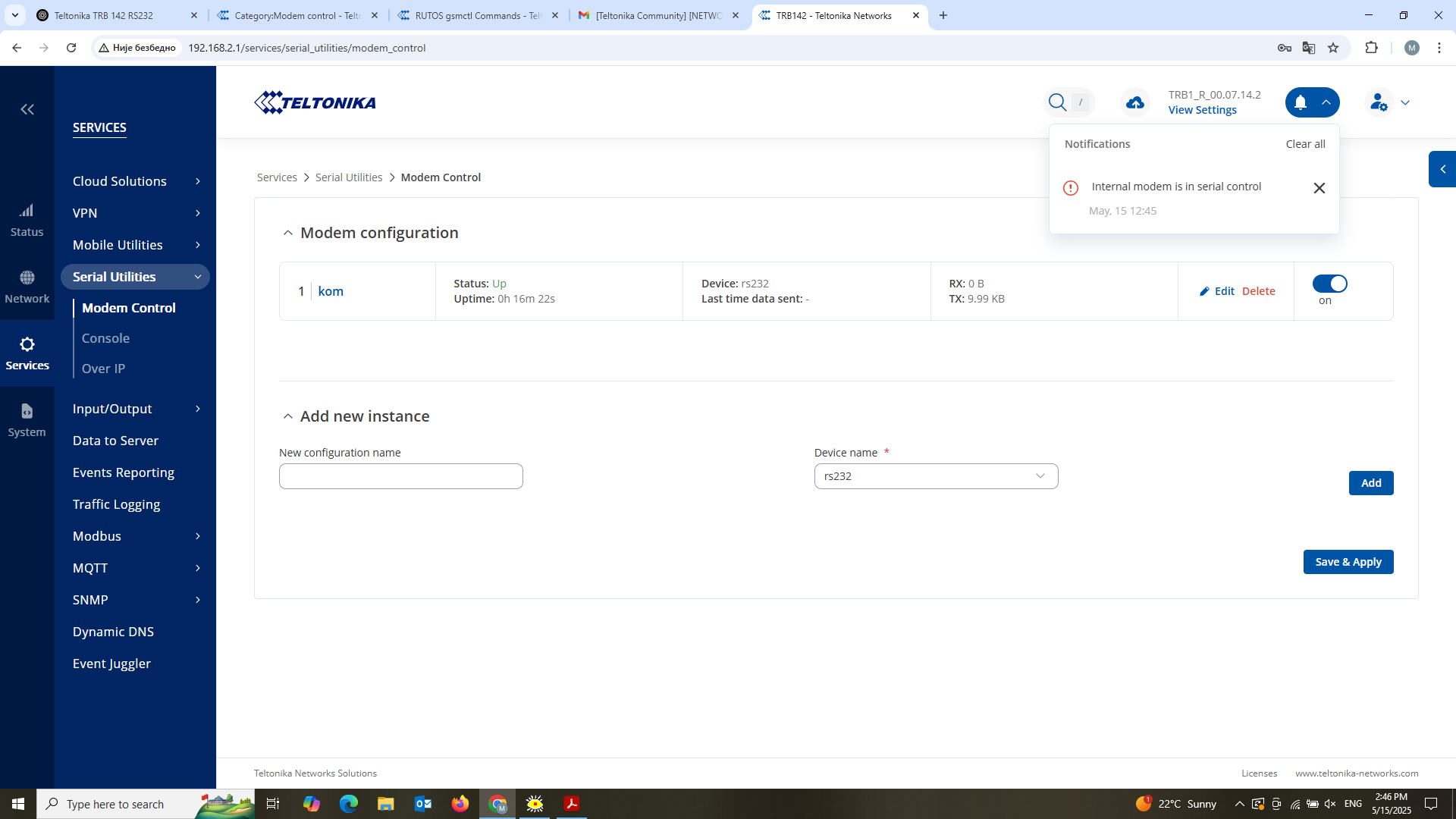

Updated the latest firmware, Go to Services >> Serial Utilities >> Modem Control, Add a New Instance with the same communication settings as defined in the controller application, Mode has to be set on Full Control. In this mode, the TRB142 modem is completely started when the 2G, 3G, 4G LEDs are blinking and all signal LEDs are OFF.

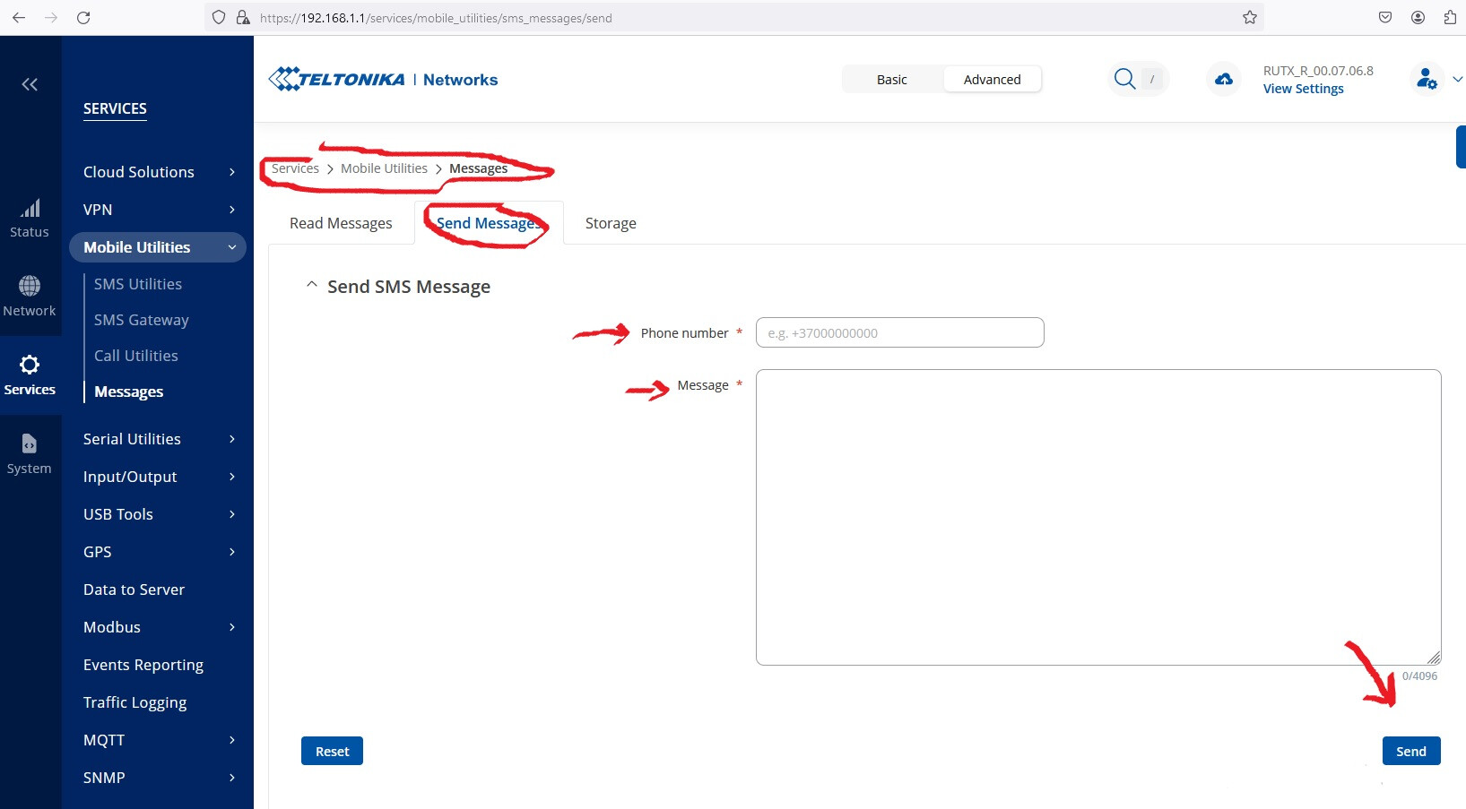

I tried to send a message from the router itself, but it was not possible

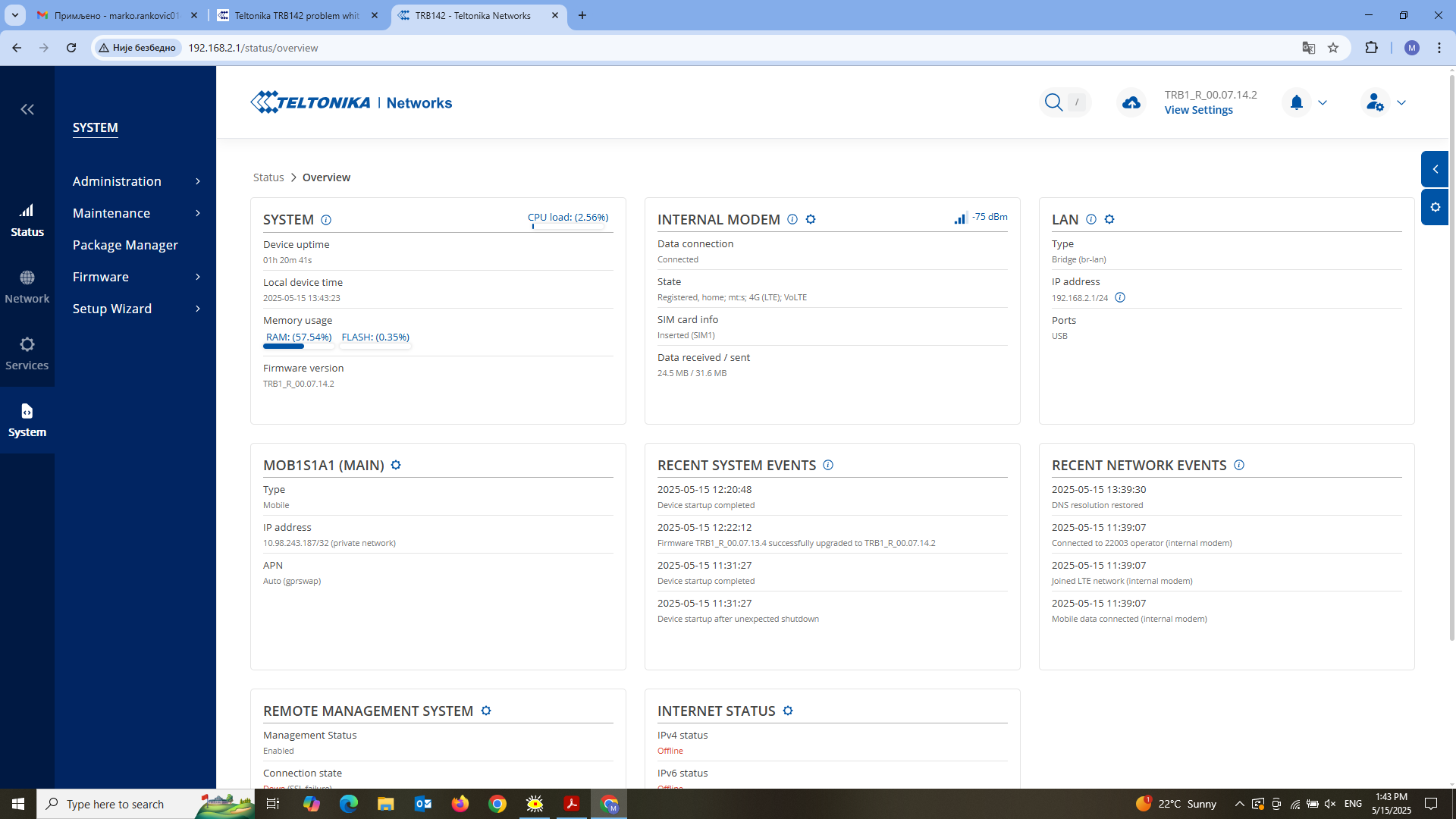

From the screenshot, it appears that your gateway is running firmware version 7.06.8.
Could you please update your TRB142 to the latest 7.14.2 firmware and let me know if the issue still persists?
You can download the latest firmware here: TRB142 Firmware Downloads - Teltonika Networks Wiki

However, for full AT command functionality — as you’ve mentioned that RS232 is configured in Modem Control — you’ll need to follow these steps after enabling RS232 in Full Modem Control mode:
  1. Connect the RS232 port from the TRB device to your PC.
  2. Open PuTTY (or another serial terminal) app on your PC, select Serial connection type, set the correct COM port and baud rate, then click Open.
  3. In the terminal, enter the command: AT+QCSQ=0 to disable continuous +QCSQ output.
  4. Type ATE1 to enable local echo (so you can see the responses like “OK”).
  5. You can now send any AT command — for example, the command to send an SMS message.

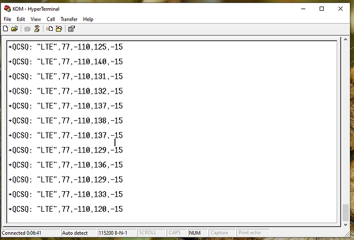

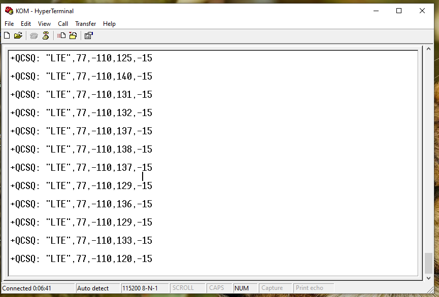

I set up the router as you told me, the pictures are attached. I connected the router to the PC via rs232. When I connect via HyperTerminal, +QCSQ: “LTE”… is displayed on my screen,
the picture is attached. It won’t let me type the at command.
Could you please try the following steps in your terminal:
  1. Enter: AT+QCSQ=0 — this disables the continuous +QCSQ output.
  2. Then type: ATE1 — this enables local echo, allowing you to see responses like “OK” after each command.
  3. After that, you can send any AT command.
