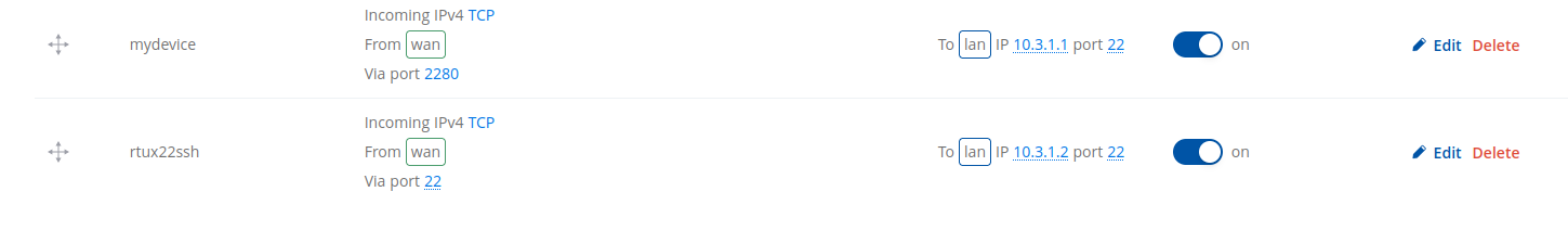

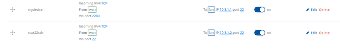

I am trying to port forwarding to other device connected with RUTX50 in same switch.
Both devices are available for each other but port forwarding seems to not be working properly.
I want it work through WAN (private network). Let’s say teltonika router is 10.3.1.2, and the other device with open ports like SSH is 10.3.1.1
Port forwarding on teltonika set on port 2280 to 22 (to device 10.3.1.1).
Also it does not work when im trying forwarding port 22 to 22 for teltonika device.

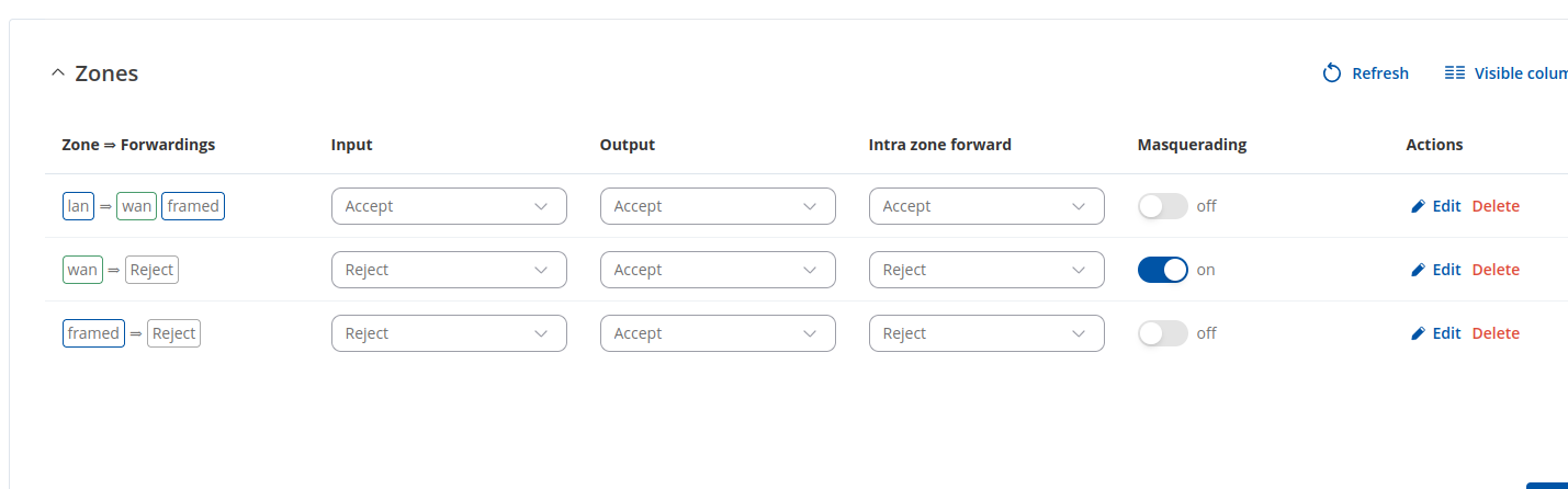

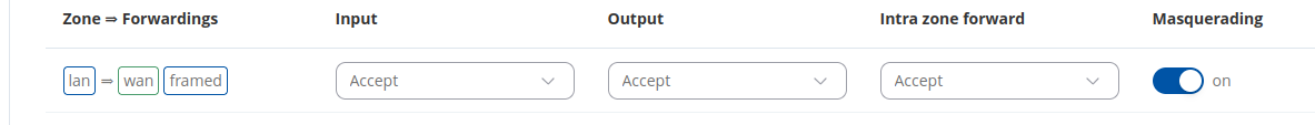

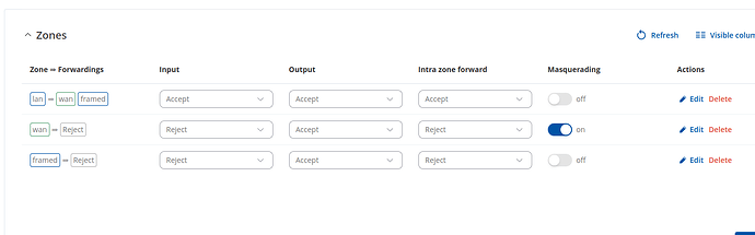

Okay i figured it out… Problem was in zone settings.
I had to turn on LAN->WAN Masquerading
Then i don’t need to add default gateway on my device. Now everything work as expected.
