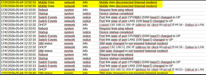

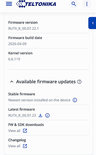

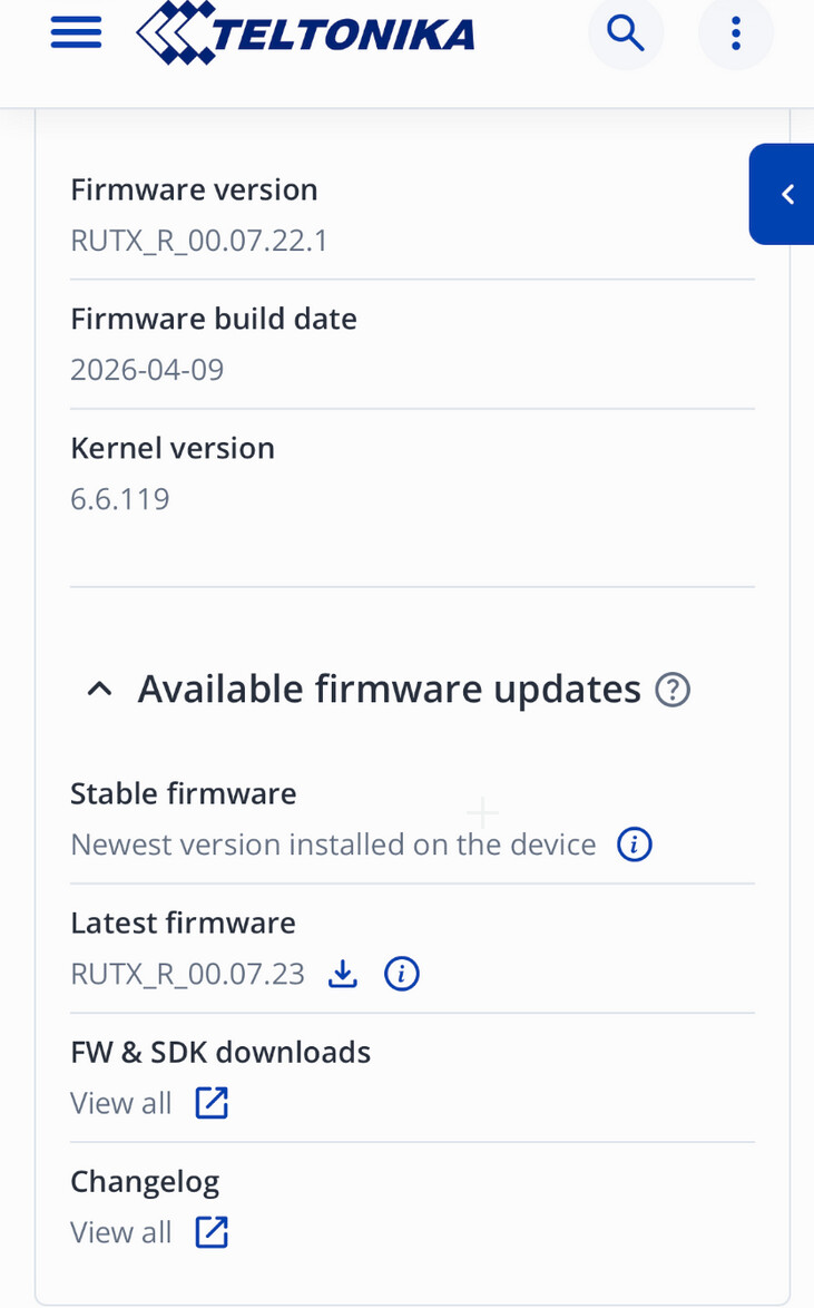

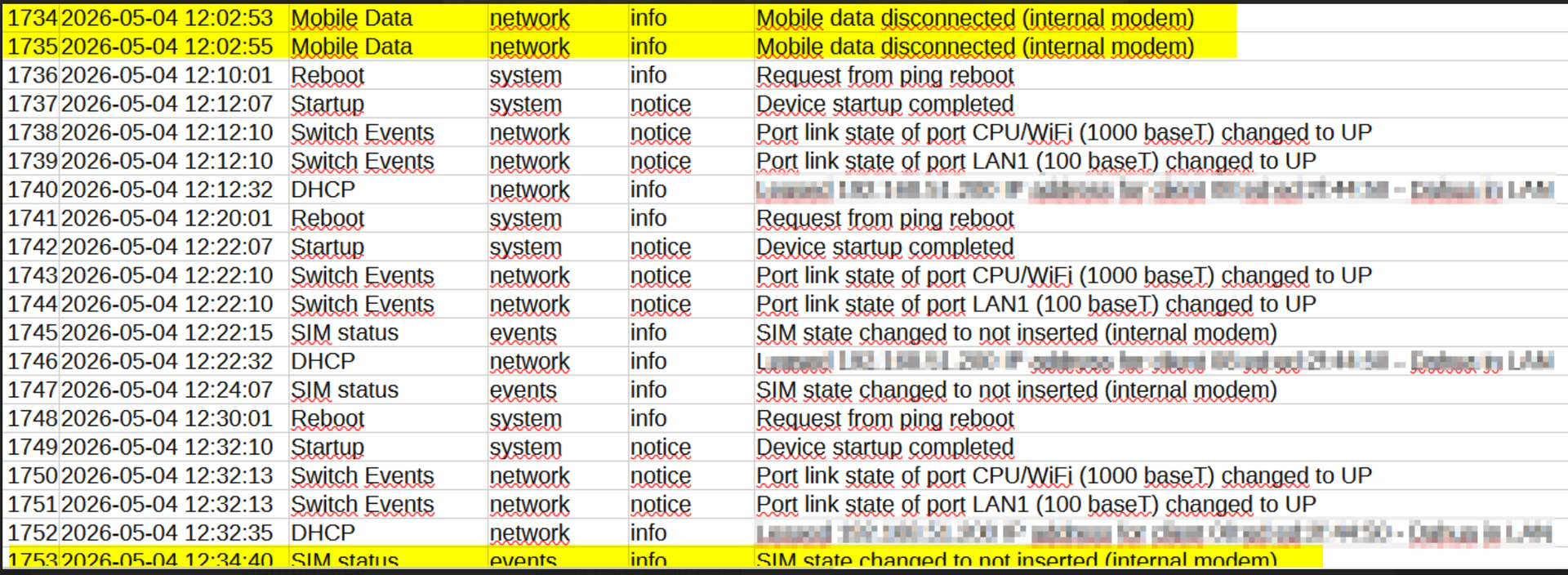

Hello, after updating the Teltonika RUTx11 router to the latest software RUTX_R_00.07.22.1, problems started, the router disconnects from the network. It loses the SIM card. Often after 12 hours, but it recovers, but after a while it disconnects again. I set it to reboot the device if the internet connection disappeared, but that didn’t help.
