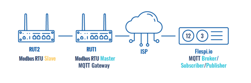

I want to clarify whether the data you’re referring to is Modbus RTU data transmitted over serial RS232. If that’s the case, there are two distinct methods for sending this Modbus RTU data to an MQTT broker, such as Mosquitto.
Approach 1: Using the MQTT Gateway Feature
In this scenario, the RUT955 device will operate as both a Modbus RTU Master and an MQTT Gateway. This can be visualized as follows:
You can find detailed configuration instructions on this page:
As an example, if you intend to send data to Flespi.io, you’ll notice that the RUT1 configuration’s host field is populated with mqtt.flespi.io. If you’re utilizing the Mosquitto application, replace this with the IP address of the PC running Mosquitto…
To better understand the MQTT Gateway feature, review this page:
