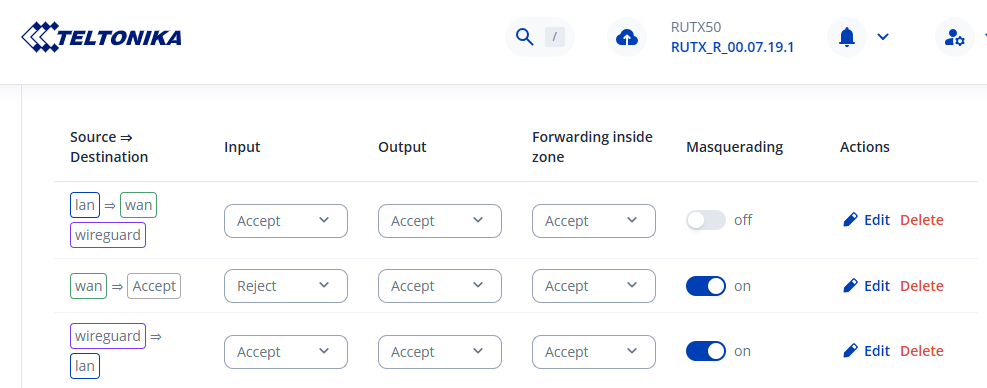

I installed a Teltonika RUTX50 on a small autonomously controlled boat. A Raspberry Pi4B is installed on the boat. It has the static IP 192.168.2.2. I also installed a Windows Geekom PC on the boat, which is connected to the Teltonika RUTX50 and the Raspberry via an unmanaged switch. The Windows PC has the IP address 192.168.2.10. I connected the RUTX50 to another Windows laptop via a VPS server. I want to access the local network 192.168.2.0 from my Windows laptop in order to send the data from my boat’s autopilot from the Raspberry to the laptop. The Wireguard connection works. I can ping the router via the Wireguard IP from my laptop, and the VPS server can ping both the RUTX50 and the Windows laptop. However, neither the VPS nor the Windows laptop can ping the local LAN network 192.168.2.0. It seems as if the router is not routing to the network. Not even the Teltonika RUTX50 can ping the network 192.168.2.0 or vice versa. The Teltonika provides the internet connection to the raspberry pi. The Teltonika is the default gateway to the internet. The problem is that it has always worked before. Then I performed a Teltonika update and now it no longer works. I reset the Teltonika to factory default again, but that didn’t help either. I would appreciate any help.
