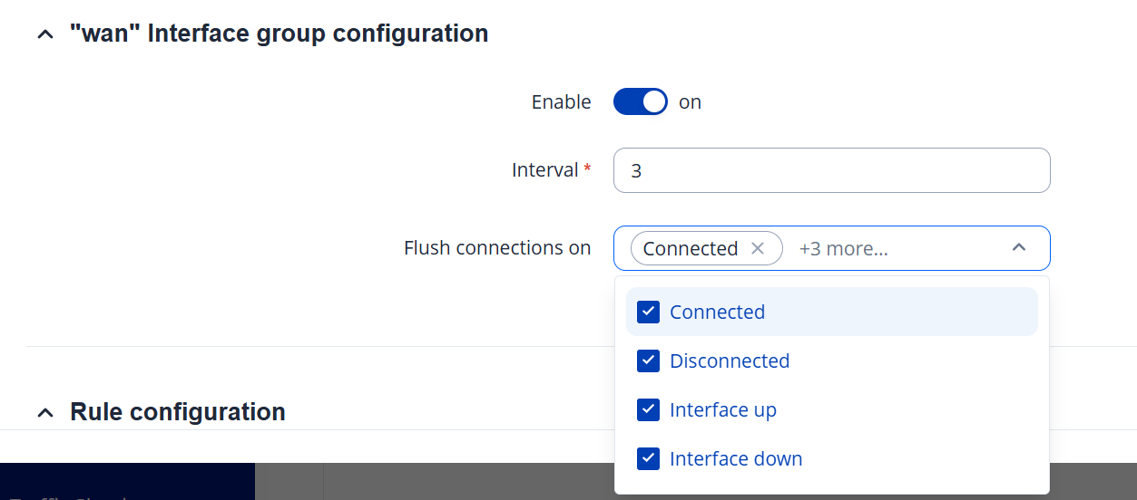

You can try configuring the system to flush connections whenever the WAN state changes. This forces the connection to re-establish cleanly. To set this up, follow the steps below:

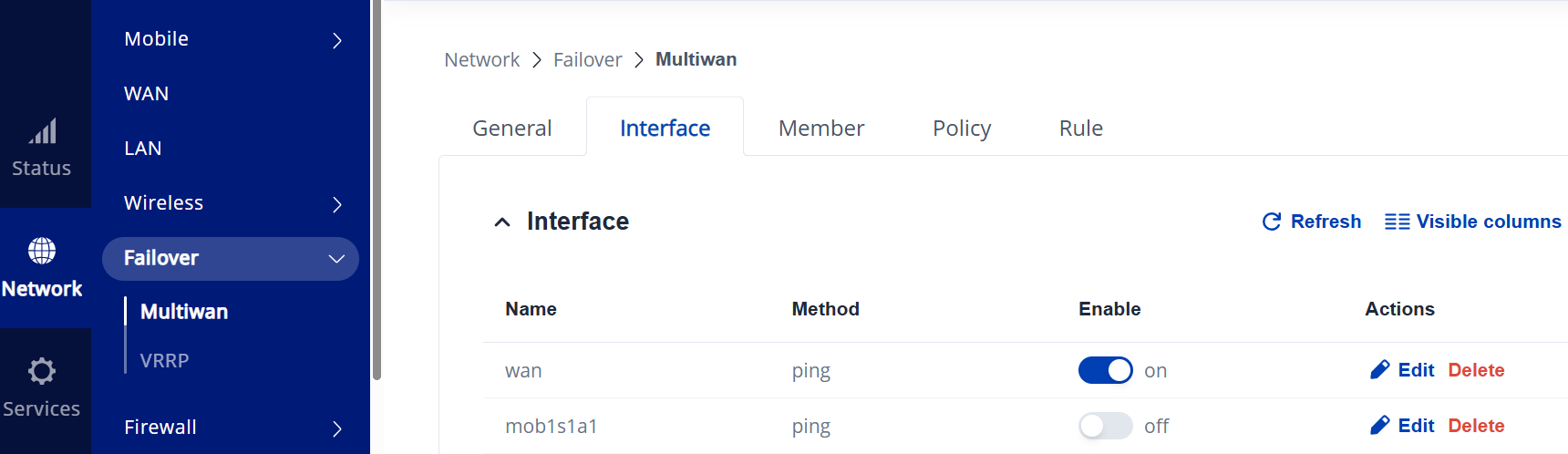

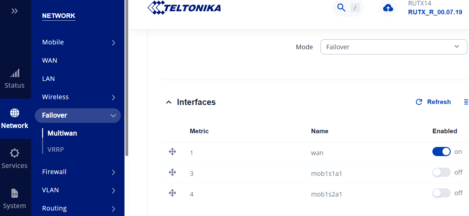

Navigate to Network → Failover → Multiwan and enable Failover for the WAN interface.
Then go to Interface, enable the WAN interface, and click Edit.
Adjust the interval as desired (the default is 3 seconds), select Flush connections on all states, and then click Save & Apply.

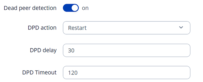

Another thing to check is whether Dead Peer Detection is enabled in your IPsec configuration. You can find this option under the Advanced Settings of the connection configuration.
