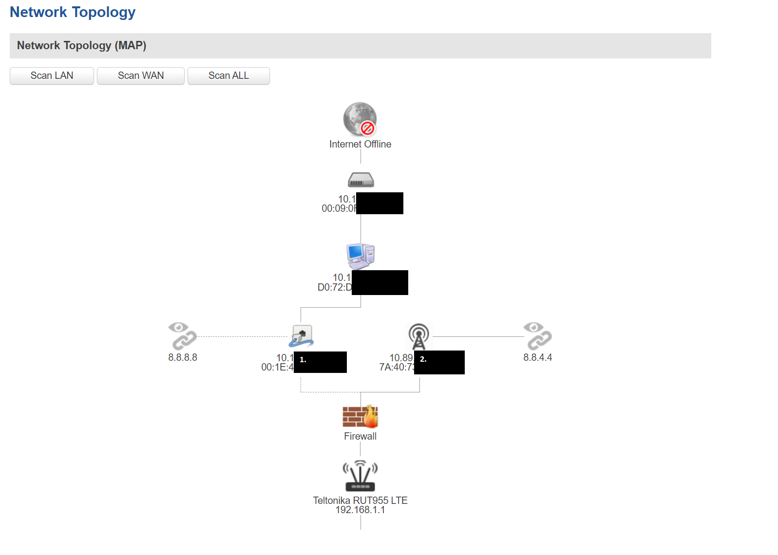

I am sending the topology of the network.
  1. (Wired (WAN) Static) With this IP i am able to connect via telnet and this is the ip that allows me to connect to WebUI.
  2. (Mobile (WAN2)) IP not reachable
    I feel like I’m missing something :face_with_diagonal_mouth:
Are you using a private APN on your mobile network? Your mobile interface has an IP address that starts with 10.x.x.x. This is a private IP address range and thus, it will not be reachable over a publiic internet. To reach the device, you will need to etiher have a public IP address on your mobile interface, or use VPNs. For public IP address, you can contact your ISP to see if they can provide you with a public IP. They may give you a specific APN for that. If they do, you can configure custom APN on your device in Network → WAN → Edit mob1s1a1 → disable Auto-APN and enter your custom APN.
