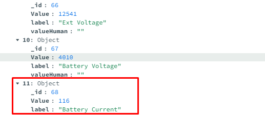

Hello.
Can anyone guide me what is meant by battery current in the attached snip ,
sometime it shows 0 or sometime it shows some numeric values. What does these values means ?
Hello.
Internal battery charging current.

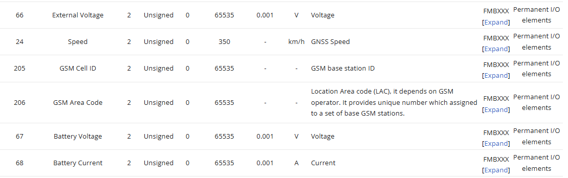

Hi @usman.javed,
Good day! Here are the description regarding the parameters associated with the AVL ID List on your screenshot above.
For more information about the list of AVLD IDs, you may refer to this link: https://wiki.teltonika-gps.com/view/FMC920_Teltonika_Data_Sending_Parameters_ID
I hope this helps.
