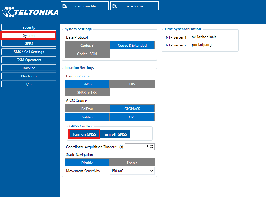

I hope you are doing well. Normally, the TAT100 GNSS module was OFF to conserve its battery.
However, you may force the device to activate its GNSS Module via the Configurator as per the screenshot below.

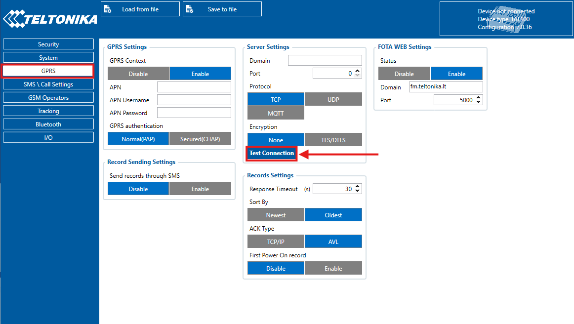

Moreover, if you just want to receive a record on the device even without any GPS fix just to check if the device could connect to your server then you may activate the Test Connection under the GPRS Tab.
