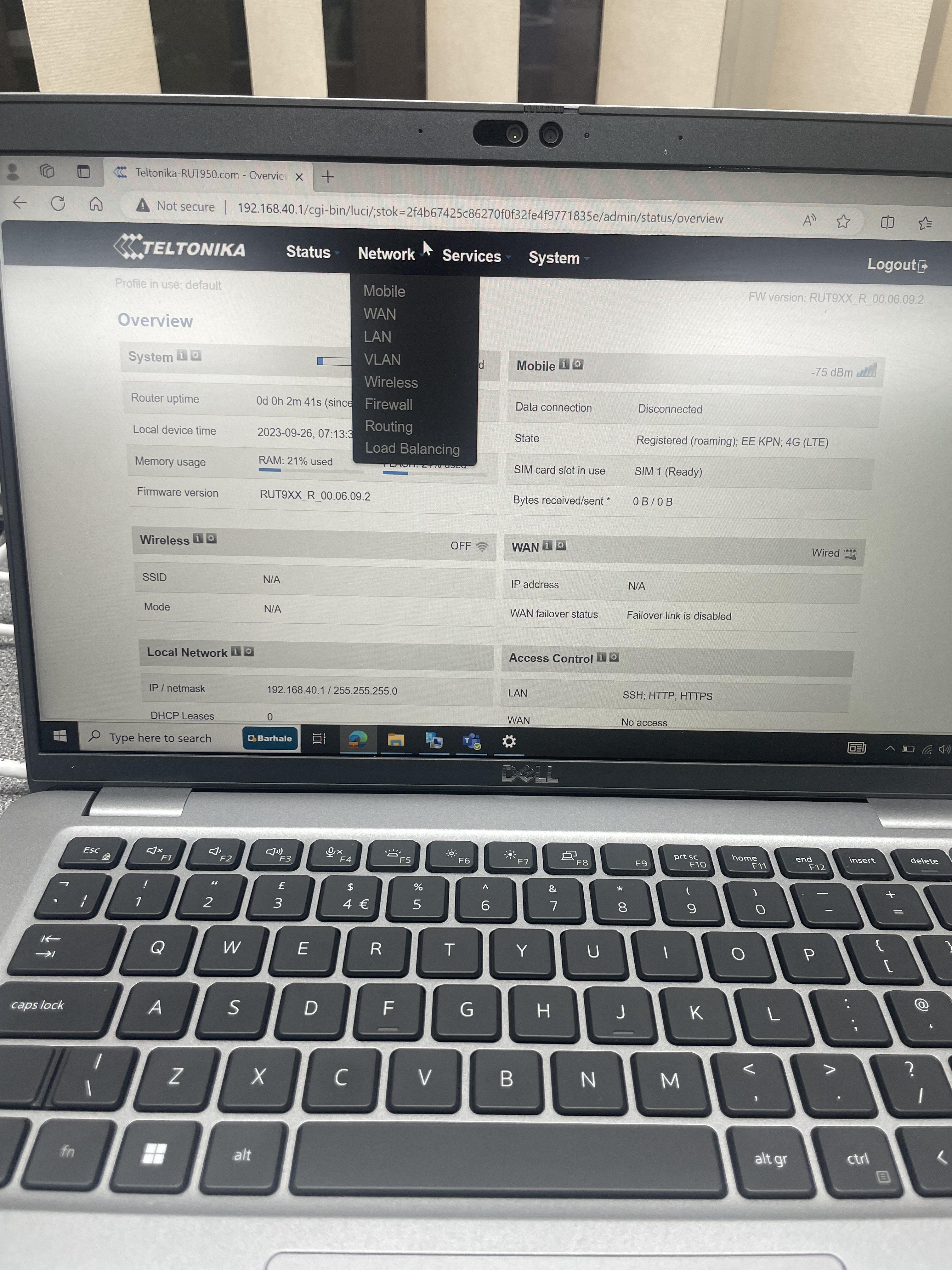

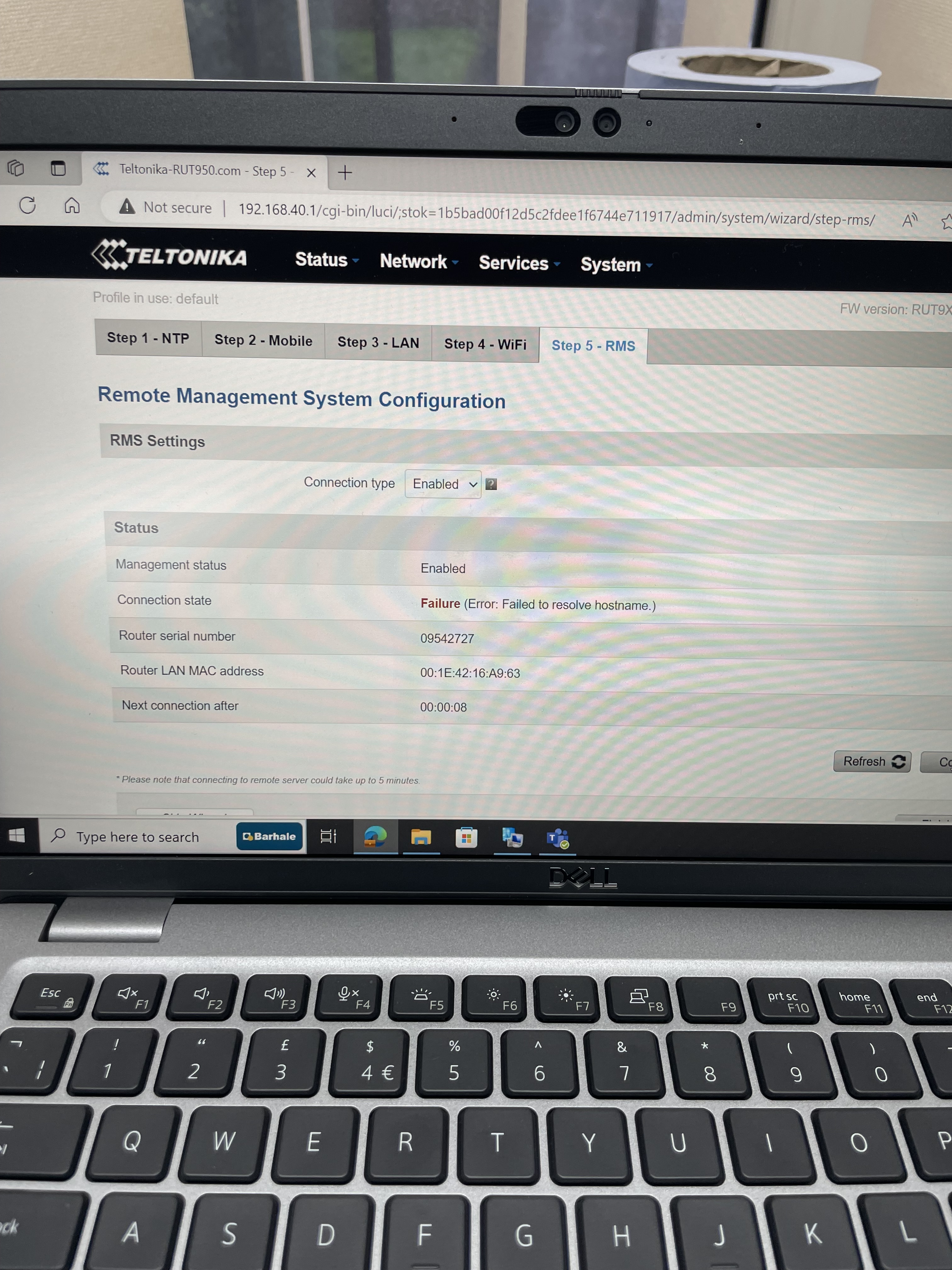

I have a static multi network IP SIM card inside a Teltonika RUT950 I have have been sent the APN settings by the supplier and put the APN settings to custom, I have configured a VPN on the Teltonika but I can not get it into the RMS as it says error failed to resolve hostname.
I put the SIM card into a phone and I have data I put it into the Teltonika and run a network cable from LAN 1 into the computer and there is no internet access.

  • The ‘failed to resolve hostname’ error can be related to DNS servers. Thus, after you update the firmware, navigate to Network → Interfaces → edit LAN → enter ‘8.8.8.8’ and ‘1.1.1.1’ to DNS servers field.
Also, could you please check if the device is connected to the operator and obtained an IP addess? You can see this information in Status → Network → Mobile. The IP address can be seen in Network → Interfaces. Mob1s1a1 is the interface used by SIM slot 1. It should be up and have an IP address.
If there are still issues, please provide a screenshot of the Status → Overview and Status → Network → Mobile pages. Before sharing the screenshots, make sure to hide any sensitive information, such as IMEI, IMSI, ICCID, etc.

Also, it can be seen from the screenshot that the device is connected to the operator, but no data connection is established. Make sure that:
  • SIM card has data available.
  • SIM card is allowed to be used in routers.
  • ‘Deny data roaming’ is disabled in Network → Mobile.
  • The APN you have entered is correct.

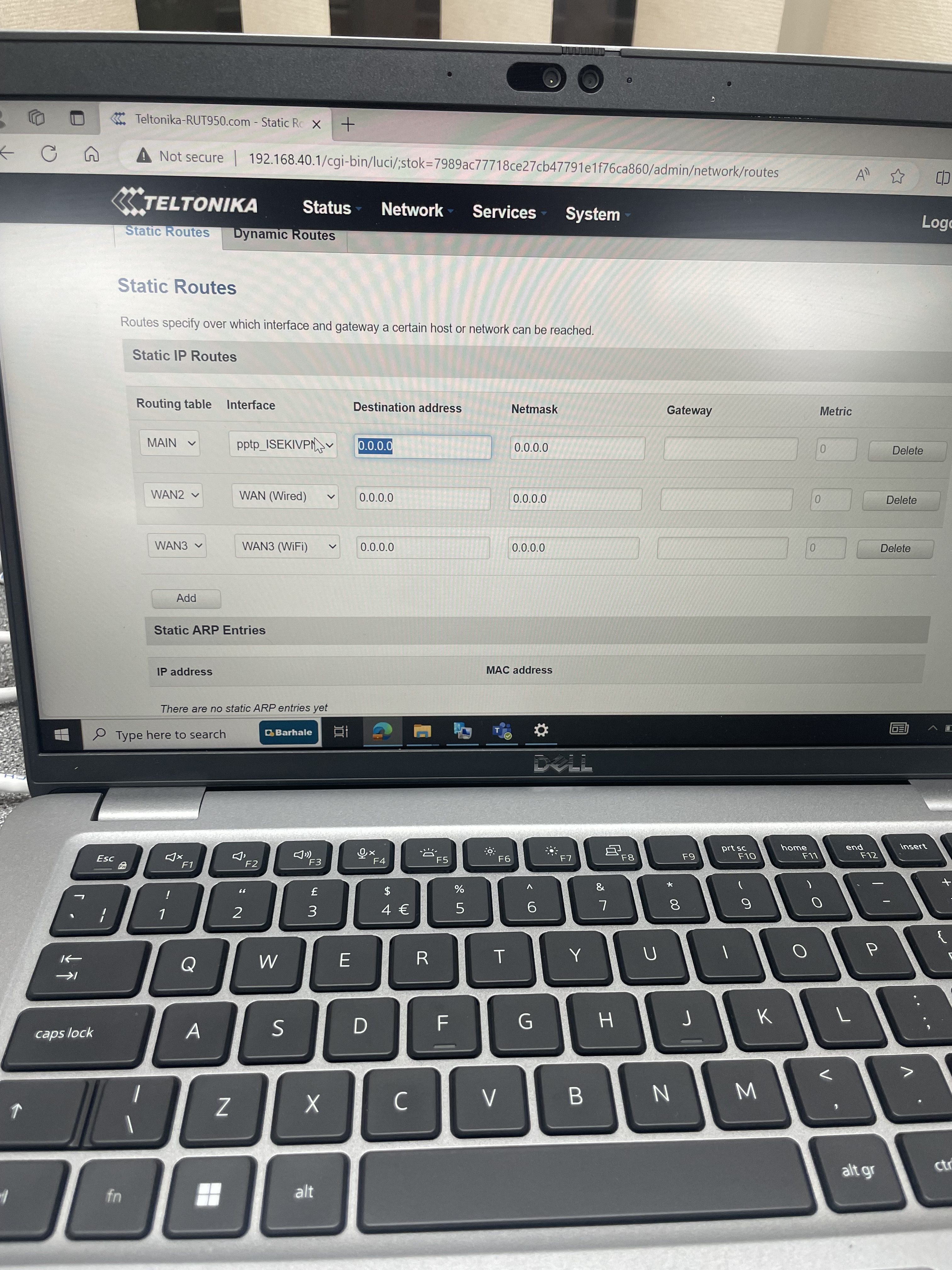

Does the sims static IP have to be filled in here?

You do not need to fill in any IP addresses nor routes for the SIM card.
