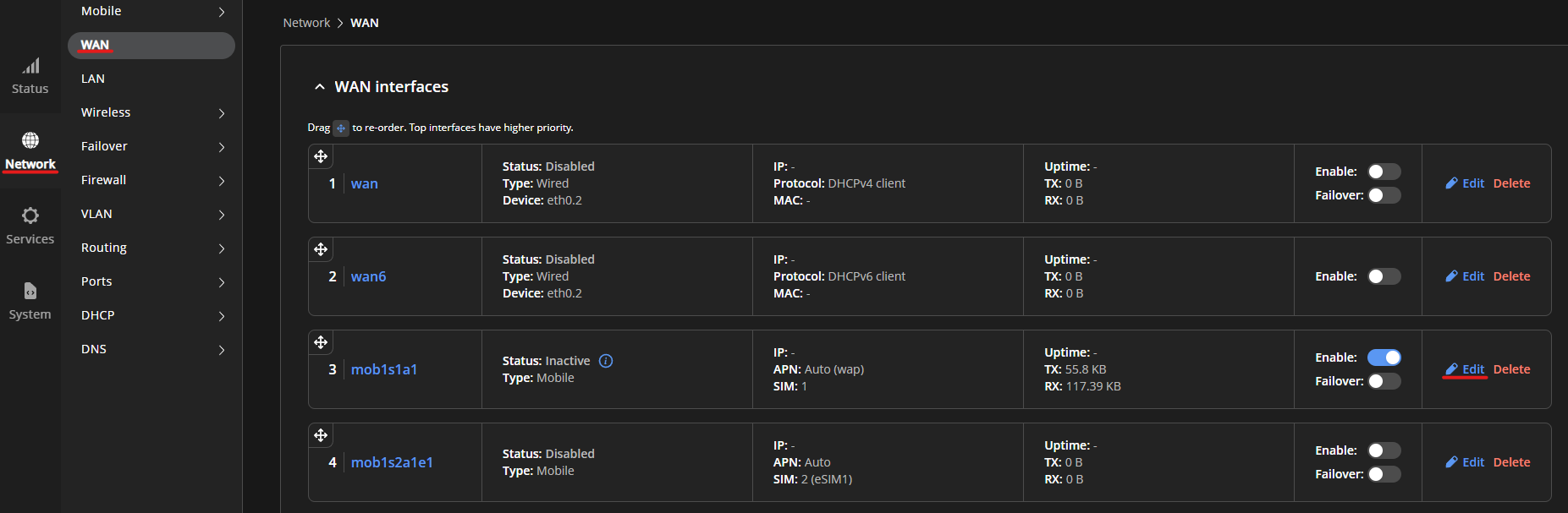

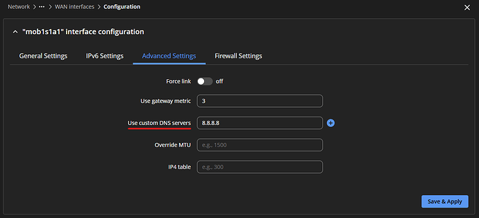

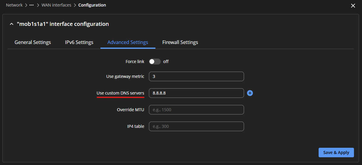

To change the DNS settings in the device’s WebUI, navigate to Network → WAN, then select your primary WAN interface by clicking Edit. On the interface configuration page, open Advanced Settings and set the Use custom DNS servers option. You can then enter the DNS server(s) you would like to use.
We recommend testing with one of the following public DNS servers:
Google DNS: 8.8.8.8
Cloudflare DNS: 1.1.1.1
Please let us know the results so that we can continue investigating the issue.

Changing DNS to 1.1.1.1 and / or 8.8.8.8 does not solve the issue. Using fw 7.24
