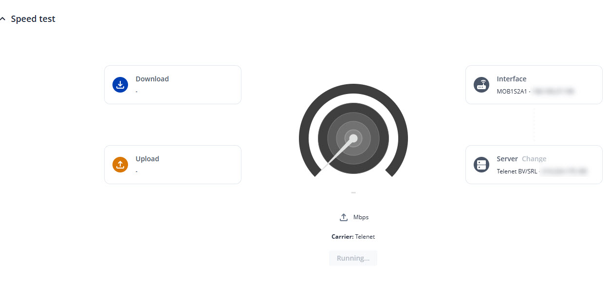

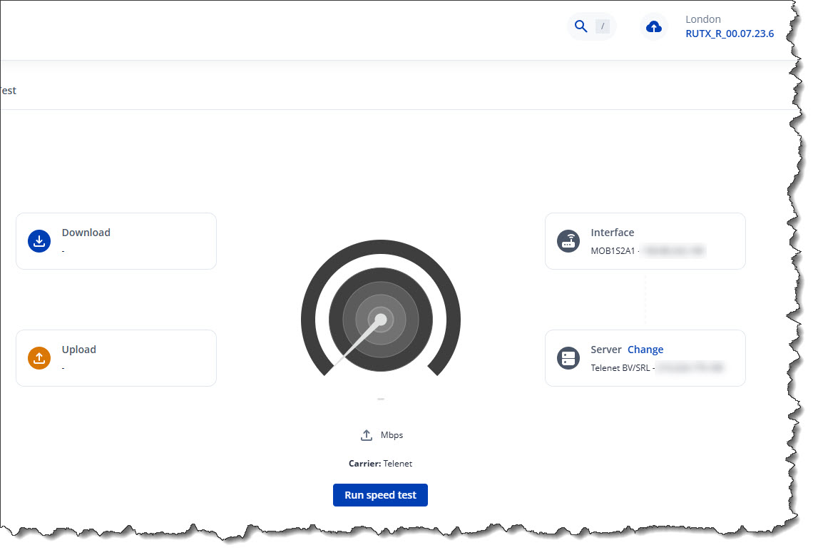

I confirm, speedtest does not work. My configuration is RUTX50 eSIM, 1x classic SIM in position 1. With previous firmware versions, speedtest worked.

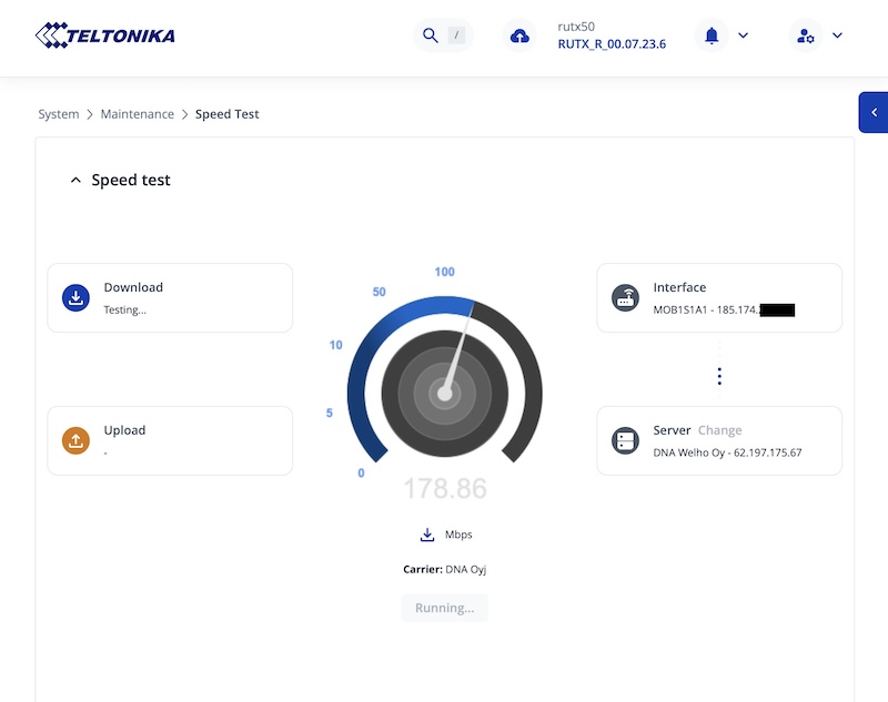

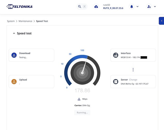

7.23.6 Speed Test works on my RUTX50.
Device: RUTX50
Kernel: 6.6.126
Firmware: RUTX_R_00.07.23.6
Build: 4e4c635823
Build date: 2026-06-12 06:33:27
Carrier: DNA Oyj
Interface: MOB1S1A1 - 185.174.xxx.xxx
Server: DNA Welho Oy - 62.197.175.67

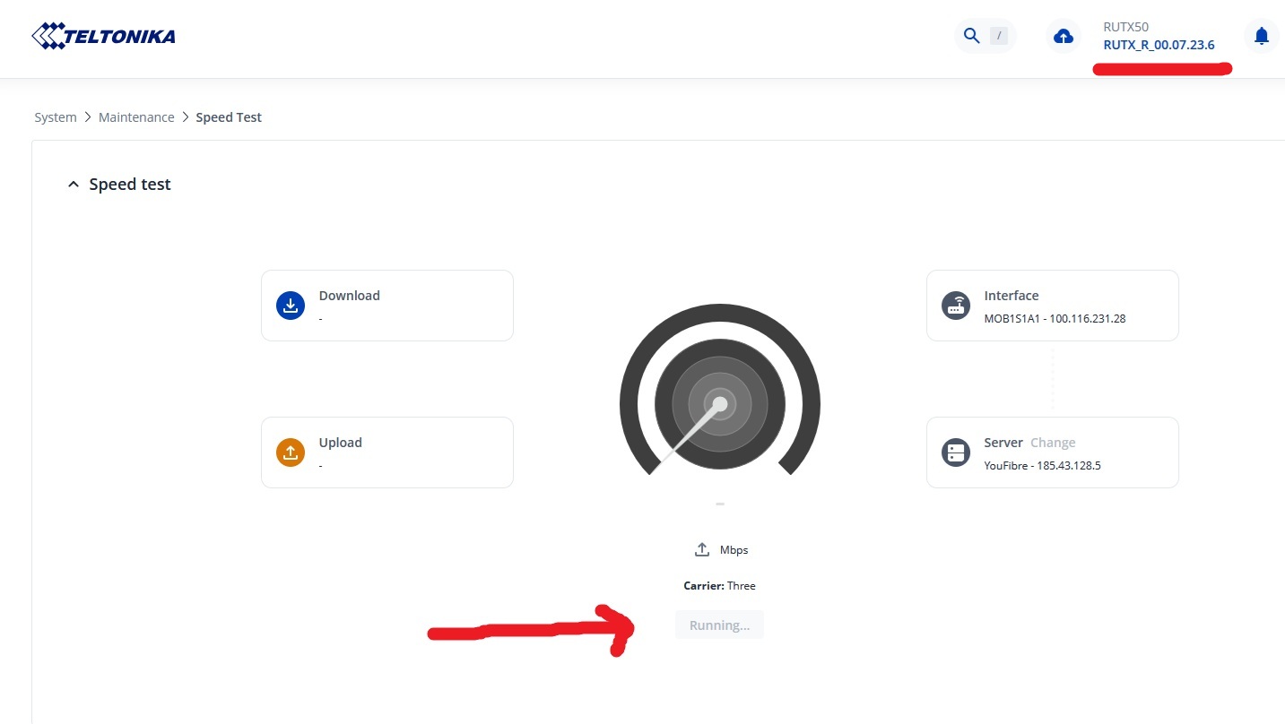

@akwe-xavante Great, it isn’t DNS.
I just tested towards YouFibre - 185.43.128.5 (Stockton-on-Tees) Server your picture shows and it’s not working for me either. I tested all their 4 Servers and it appears Manchester and London works, but Stockton-on-Tees and Edinburg are down.
They have may some sites technical issues, any effecting work in progress, or have just limited source addresses these test sites accept testing and thus not answering from where I tried.
How if you try yourselves. Click Change near Server and select some other servers, for example YouFibre London or Manchester if they work better with you too.
By default opened selection screen shows only same country Servers where I’m from, but using search box above I could find easily others too.
Indeed a couple of servers do work but the ones automatically selected and linked to the respective provider of my 2 simcards don’t work. For example my provider Telenet BV/SRL - 213.224.175.169 does not work but when I browse to https://www.speedtest.net/api/js/perform-redirect?server_id=15212 using my desktop browser it does work; unfortunately the IP is not displayed but I’m pretty sure it is the same server as Telenet only has 1 speedtest server listed
Tried manually selecting different servers to run speed tests the majority “Do Not Work”.
I did get just one to work correctly after trying approx 7 servers.
@Clipper87 Right, Server / service side issues are not generally unheard of class problem.
I don’t know if those speediest service providers aim certain SLA or not. But it isn’t terribly hard to build and maintain service side services so that this kind of outages don’t make unassuming clients and their equipment fall wrong conclusion that they have problems in their devices.
Out of several options how it’s quite cheap and scaleable all it would require them to make service DNS records (RR’s) updated with a short TTL (time-to-live) value and then just drop out from that pool those that failed. Because speed tests are quite much traffic it would be advisable to delegate that a separate subdomain from main to completely separate DNS-server where that dynamic updates with short TTL’s don’t cause operational burden to main DNS. All things considered, not much more than single workday build this kind of thing. And it really doesn’t require much of maintenance beyond normal operations. Contrary actually, as now the frees doing updates/upgrades/migrations ordinary work hours without outages as long as at least one of these services is kept running.
From the client side, like Teltonika device in this case, what they could do is to add a simple test to that test page, is check first quickly if the server picked is reachable. If not, then either pick random nearby or disable and switch “Run speed test” button text to “Choose server first”. And then perhaps while generating Choose list test quickly contact each server with “nc” or language generating that page socket binding and gray out those servers which were not reachable. Or something like that which UX designers possibly have good ideas how it should be presented to user.
@akwe-xavante
OK, if you got even one working then fault is not in your router.
It’s your mobile or WAN side network connectivity issue somewhere upstream network.
A problem known as BGP ‘routing screwup’ most likely, between service providers or within your own service provider internal network issue. It’s not a thing you can fix by yourselves. You either wait until they fix or you may contact and tell them about the issue, which can speed up especially if they haven’t for some odd reason noticed that themselves. That kind of things happen and are not uncommon.
if you contact, it’s usually helpful to attach traceroute output. That’s a CLI tool that prints what path packet go from your system where you run it towards an IP address you gave to it. It sends packets one hop at time printing as it goes RTT (Round-trip-time) from lowest, average and longest it took. Hop’s it didn’t get reply return “*”, and it either means a problem, or just that whoever box that traffic went or is trying past doesn’t allow tracing. Either out of ignorance, not understanding it would be a good and beneficial feature core network wide to allow it, or it’s a security policy mandate not allowing for real or imagined reasons and nobody else business they tell even if you ask usually.
If you need you can speed up traceroute a bit using -n option, so that it doesn’t resolve addresses while it goes. But if you send output to someone for debug, please include names, it usually is helpful information to see NOC folks which way it came and they don’t have to resolve names themselves. You can find contact information of who to report from WHOIS or RDAP services. It’s bit of work, but bright side is you learn more how internet works if that is your thing you are interested.
Remember staying polite while you report and your changes getting taken seriously are better. Showing evidence kind ways, like
“It seems from where I run this traceroute, that there is an issue somewhere there … and could you perhaps take a look and see if there is something you could make to get it fixed, please. Then add that raceroute and add what service you were trying to reach.”.
Internet is collection of interconnected individual mostly autonomous networks exchanging traffic either peer-to-peer or purposely built facilities known as IX (internet exchanges) there isn’t any single instance or party that would be able to fix things for you. Each party takes care of their own gear.
For an individual non professional network customer best option is to contact is always your own operator and service provider. They know these things how to approach solving routing issues. Speed they act depends usually greatly how important and much paying customer you are. Most important gets fastest turnaround and cheap consumer customers bit less.
Issue began imeadiatly after firmware upgrade and others are experiencing the same issue now after they upgraded. However it could just be a coincidence too.
Yes, could be coincidence or something else. Like if your operator side IP also changed after boot DHCP serivice decided to roll over new IP block retiring old from use.
If and when that happen it’s that new IP perhaps if not same address range it could be that service provider is rearranging addresses. Depending if your outside address is public IP, RFC 1918 or they are short of IP’s and turned on RFC 6598 CGNAT which overloads many customers IP’s same outside public address. And these days providers also quite aggressively make clients IP’s change denying renewing same IP after some period they have set they think is justified some privacy or just technical reason they rather not let anyone hang on some IP for too long. This latter seems to happen me at least once month, both IPv4, IPv6 together IPv6 PD here which is nuisance even though I have DDNS managing it, though independently from Teltonika router.
Whatever it is, if it works even for one Server then fault is not within you device. Because it is very unlikely that router would anyhow differentiate DNS given IP’s and then somehow work differently within that router. No, that is nonsense, there is absolutely zero reason Teltonika or any other vender also do that kind of silliness in feature implementation.
The problem cause and issue need to be fixed is outside your system, operator side either their network or somewhere further away up before reaching those Speed Test servers.
