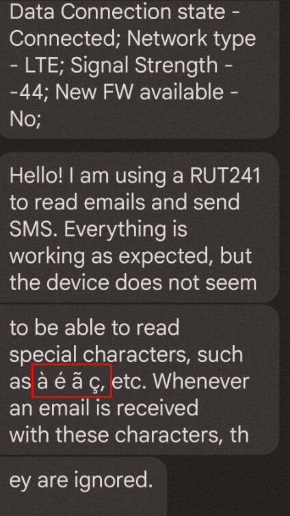

Hello! I am using a RUT241 to read emails and send SMS. Everything is working as expected, but the device does not seem to be able to read special characters, such as à é ã ç, etc. Whenever an email is received with these characters, they are ignored. If I copy the same text with the same special characters into the “Send Message” feature, it sends those characters without issue; the only problem is when reading emails with those characters. Is there some sort of setting I am missing? Thank you
I have tried to replicate your issue on FW 7.04.4, but was unable to. The email contents were properly sent over SMS:
