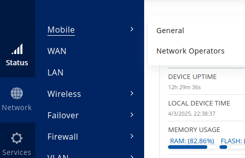

After upgrading firmware from latest legacy version to RUT2_R_00.07.06.17 the Network → Mobile menu only shows the options “General” and “Network operators”. Utilities is missing.

Thank you for your fast reply. The option I was looking for was the SIM pin management. In other routers (e.g. RUT951 firmware RUT9M_R_00.07.12, and RUT241 with latest firmware) I can find it under Network → Mobile → Utilities. I cannot find that one in Services → Mobile Utilities.
More over, in other routers there are six options under Network → Mobile:
General
Connection
Limits
Sim Switch
Network Selection
Utilities
In the aforementioned router, I can only see two options:
General
Network operators

I think still I didn’t explain it properly, sorry, I am trying to remove the SIM pin lock. That option is not present in the Network → Mobile → General.
I’ve just realized that another RUT240 does not have the Network → Mobile → Utilities menu either. But the RUT241 has it it. So probably that menu is only present in RUT241 models.
