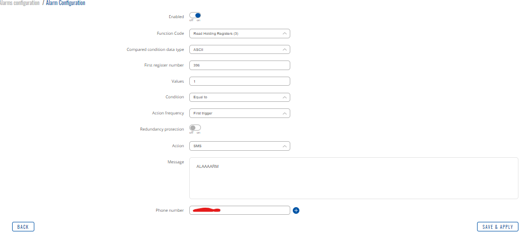

I need to send an alarm message to more than one phone number via ModBus TCP. My idea is to send a previously saved message to register number 398 by sending a 1 to register number 396 via Modbus, and that works, but to send the same message to other telephone numbers I want to use alarms.
I have tried to set said alarm in many ways but none work. I just can’t get the alarm to detect the “1’s” that I’m sending to register 396.

@JJpumero This will most likely not work, as the register almost instantly gets reset back to 0. Perhaps you could describe your broader use case to see if there could be any other way to configure the SMS sending?

The idea is to use the alarms to send a single predefined message to multiple phone numbers. The Requests method works when there is only one recipient, so I wanted to use alarms, they allow you to schedule more than one phone number.
The main condition is that the triggering of the message is done via modbus.
Saving a new phone number and its message in hexadecimal following the following tutorial: Teltonika Rut 240 send sms via Modbus TCP problem - Crowd Support Forum | Teltonika Networks (there specify the software).
To send a message with registration 396, it is enough to send either a 1 or a 0, but first you must register the relevant information in 398 using 397.
