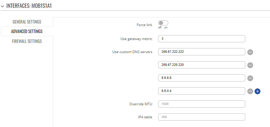

Firstly, it seems that SmartDNS (DNS) is not necessary for SmartDNS VPN. I was able to connect SmartDNS VPN successully without it.
Here are my configurations (using mobile connection, so if you use wired WAN, you can edit the WAN interface):
Network → WAN → Edit Mob1s1a1 → Advanced settings → Custom DNS servers:

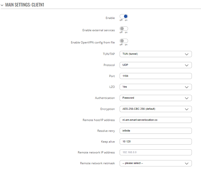

Then, OpenVPN configurations are as follows:
Username is your SmartDNS VPN username that can be found in the VPN tab in your account settings on SmartDNS.
The serverlocation.crt and tls.crt was downloaded from here.
List of VPN servers is available here.
